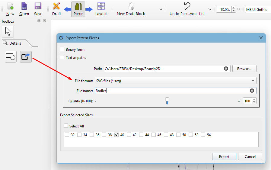

I normally arrange my pattern pieces in Piece Mode to the best that I can and then export directly from there as an SVG.
(A new addition to this is that you can now select which sizes you would like to export if you are working with a multisize measurements file.)
Once you’ve saved your pattern to SVG, you can open it in Inkscape and arrange all of the pattern pieces as you wiish. Inkscape is an open source software and also has pages that you can set up to save to a multi-page PDF, if you wish.
