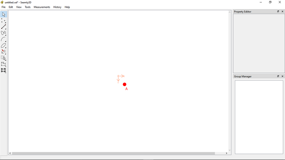

You could for example hide the Toolbox dock and all the tool toolbars except the Toolbox Toolbar,
Toolbox
which functions like the Toolbox dock in a more compact size. BTW, the toolbars generally can be docked at what position you like… top, bottom, left or right. You also have the option to hide all the tool toolbars and docks and simply use the Tool menus and / or keyboard shortcuts. Here’s using just the Toolbox Toolbar docked at the left:
