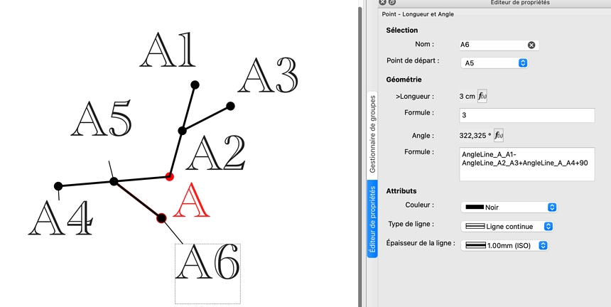

I have found a way to report relatives angles of two lines to create a third line using a fourth line as reference and I think it’s a tool that is missing.

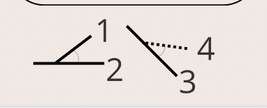

I hope I’m explaining that clearly, let’s bring a drawing. We want to report the angle of Line1 in relation to Line 2 to create Line 4 in relation to Line 3
The calculation is in fact easy and just : AngleLine1-AngleLine2+AngleLine3
Is it possible to create this tool ?

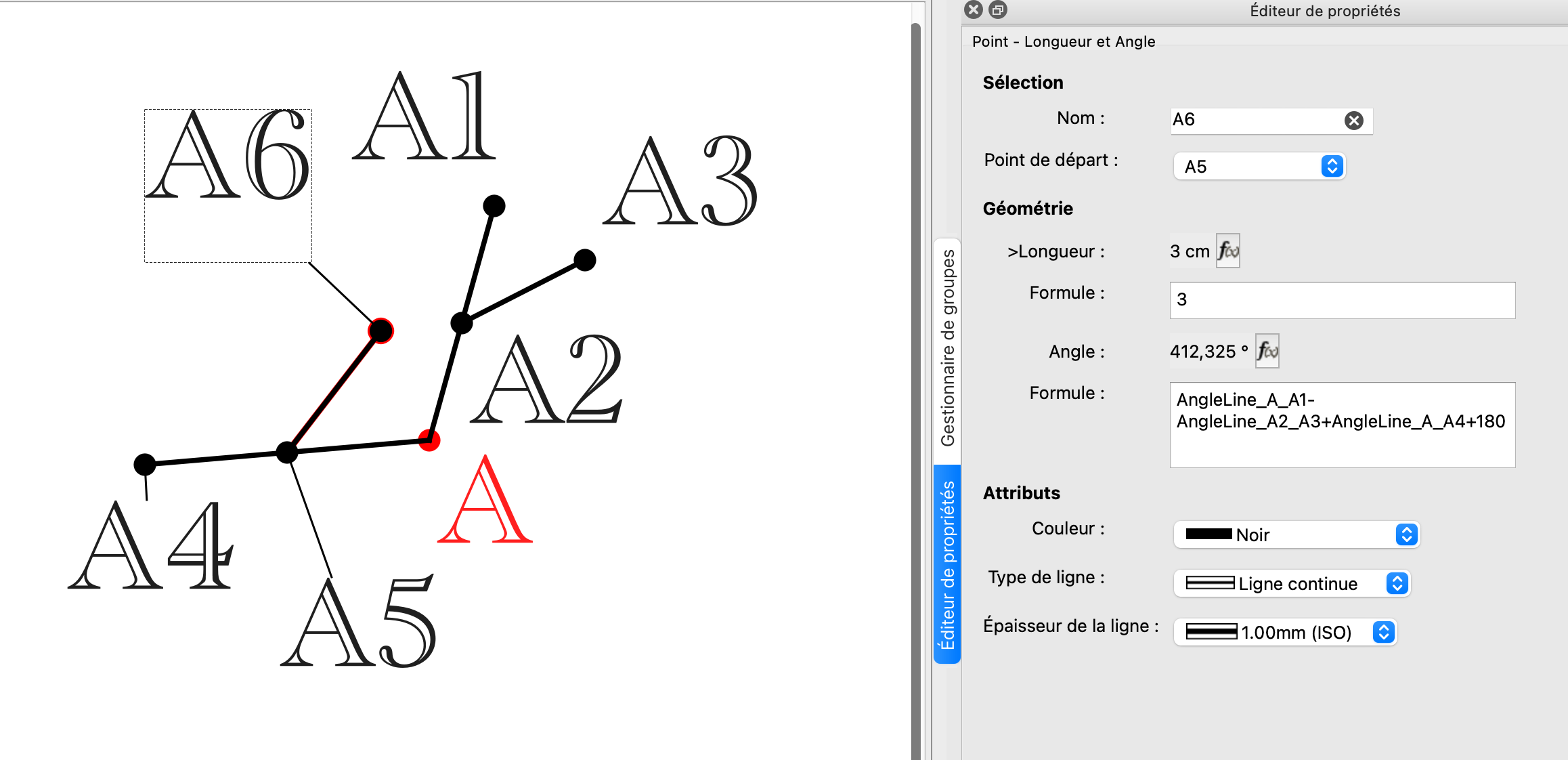

Yes currently I add the formula manually but a tool would really speed up the process ! could work as this tool

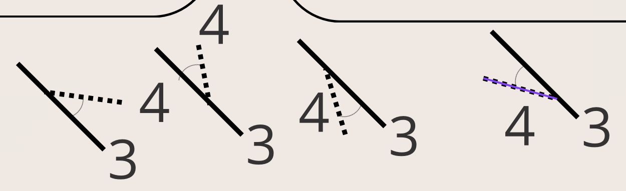

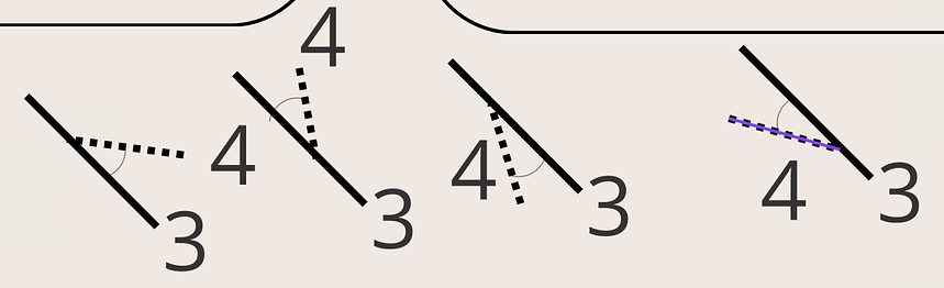

when you choose the first or second point of intersection. Here you’d choose one of the four ways

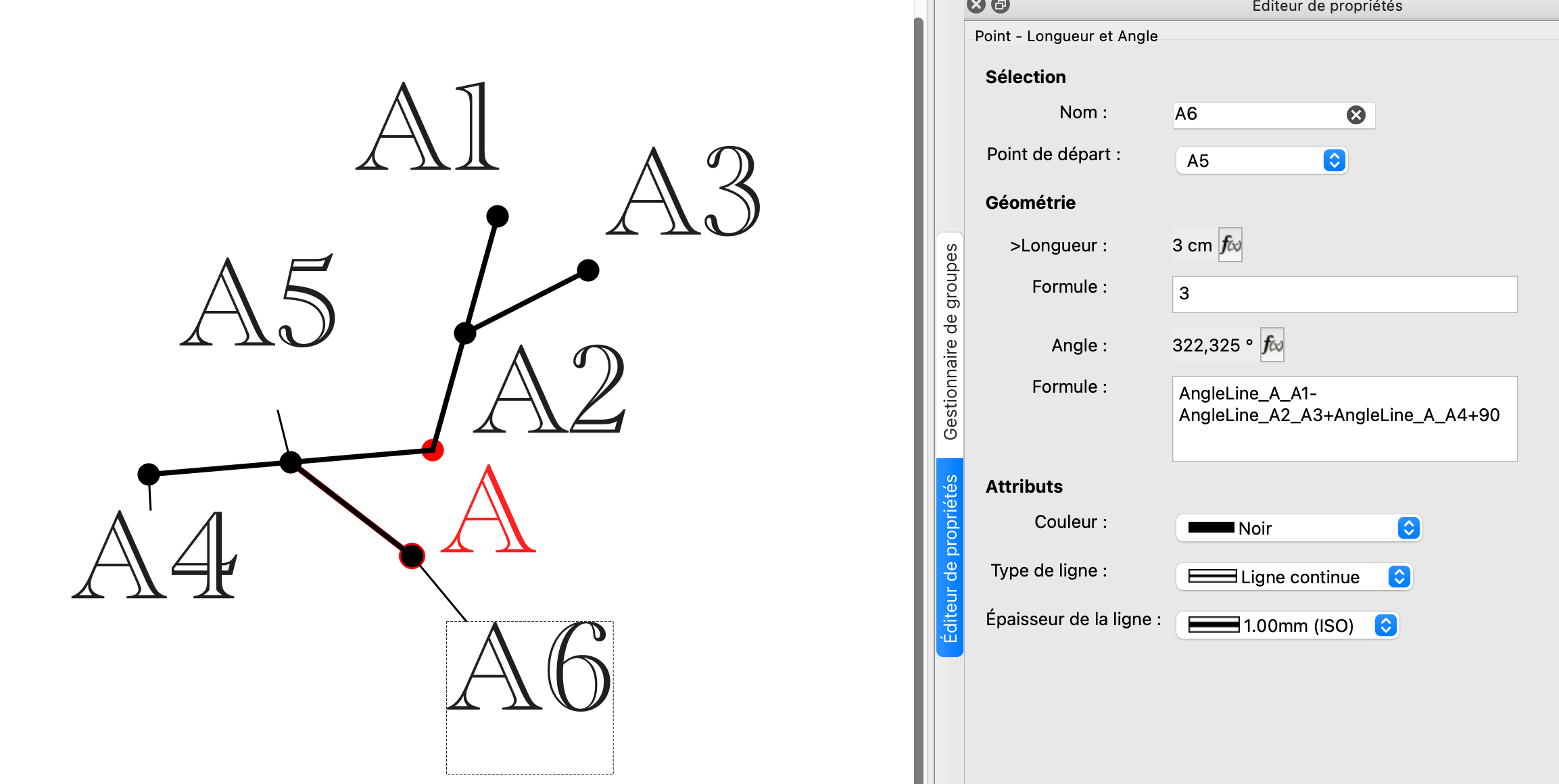

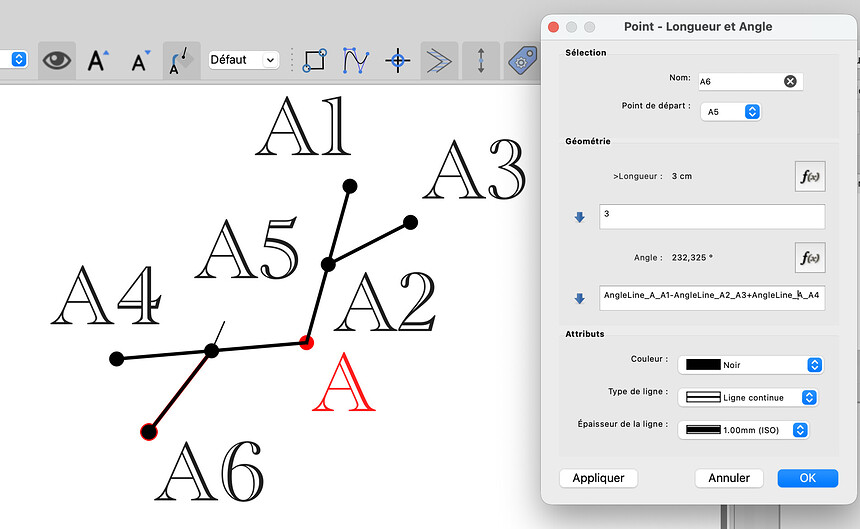

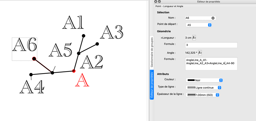

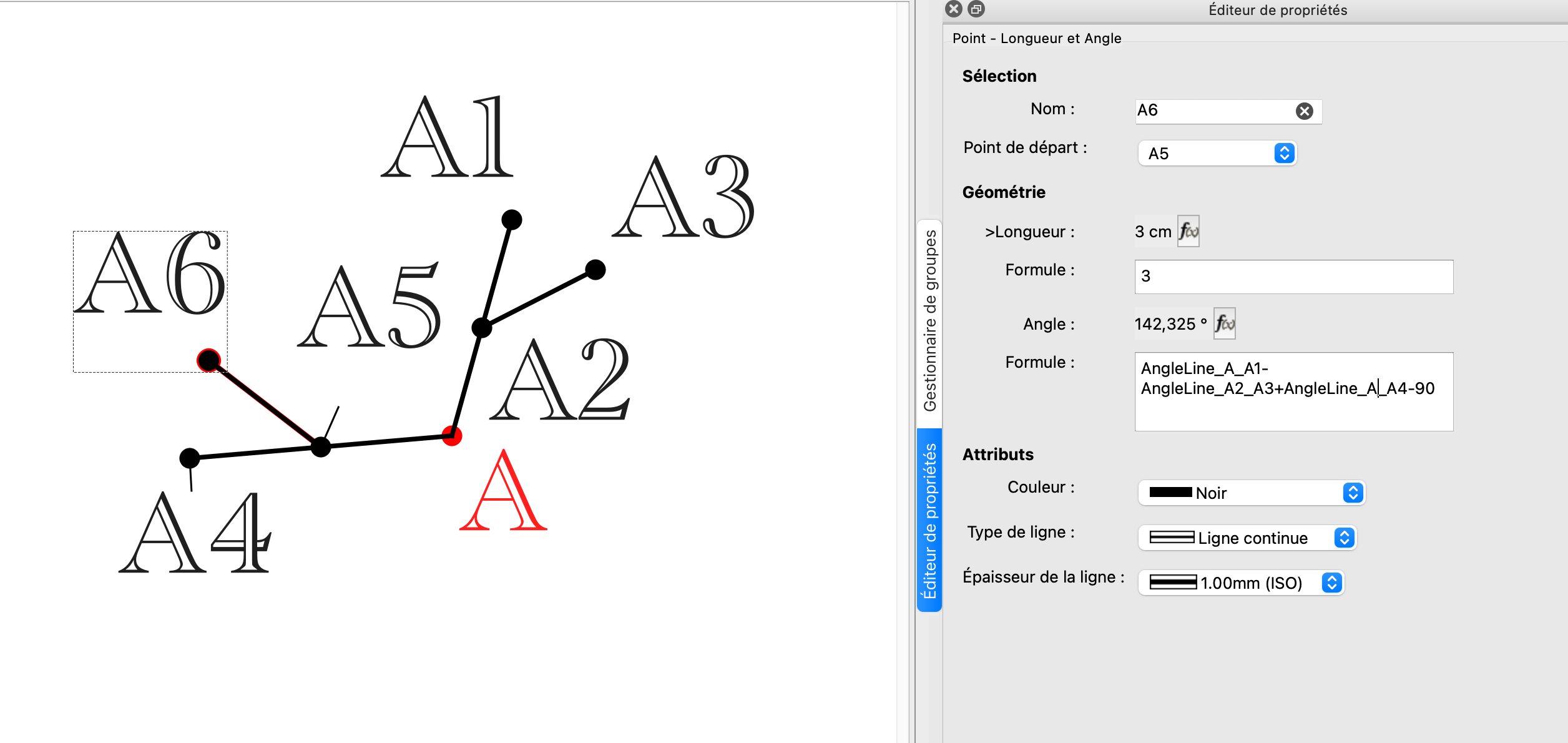

To orientate the new line the way I want I add few +90°/180°/-90°/ and it worked.

Sometimes the +90/etc doesn’t work I’m searching a formula to fix this !

The secret to successful formulas is in identifying where you are coming from and where you are going to. In the case of the side seam at the hip level, your formula is correct in minussing the one baseline and adding the other to the formula and then mirroring by adding/subtracting the 180°. However, you can also use the angle of control handles of curves for this purpase.
If you send me your pattern, I will be happy to have a look at it to try and find the ideal formula.
