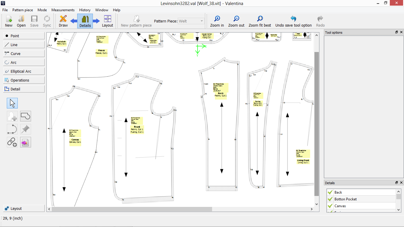

Here’s another example of a 3 button sack coat I used as a test to validate the method I used. I used a size 38 with 2" ease… or a ChestScale of 20". I have a whole set of this pattern so I was able to check to see if the pattern was grading properly/.
Levinsohn3282.val (122.7 KB)
Wolf_36.vit (4.2 KB)
Wolf_38.vit (4.2 KB)
Wolf_48.vit (3.9 KB)
3 tykkäystä
