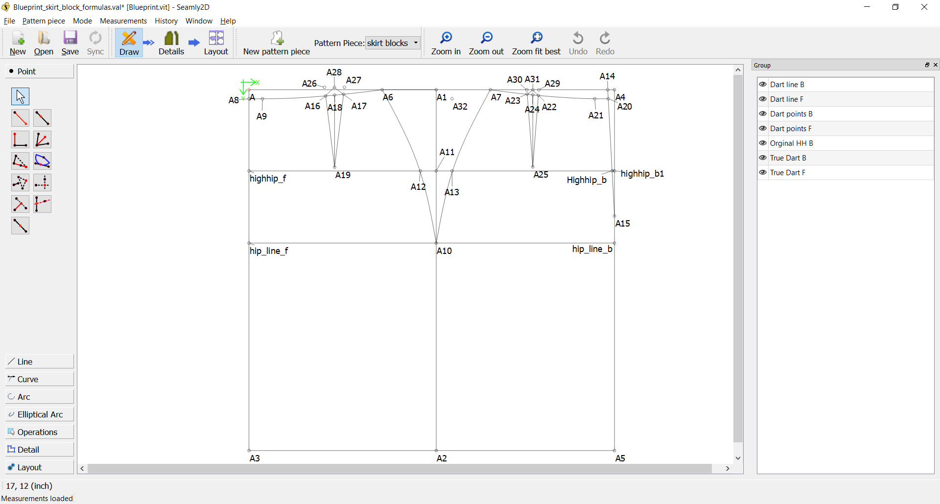

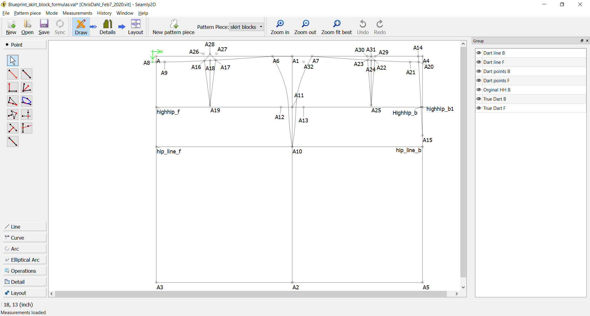

I redid my patterns using formulas and now see that the pattern does change sizes when I load the different files. However, there was still one area that didn’t work out well. Which was the curve on my side seam. The first image is my base pattern, the second one is using my own body measurements. As you can see the side seam looks a bit wonky, not sure why that happened. I could manually adjust this, but I am wondering if there is something else I can do to make this happen automatically like with the other lines. Hope this makes sense. Any feed back would be great
the only thing that I can see is that the curve does NOT pass through points A12 and A13 on the second rendering as it did in the first. This tells me that you probably did not use those points in the construction of the curve or that you did so in a way that i don’t understand.
Could you clarify what exactly you mean by “wonky”

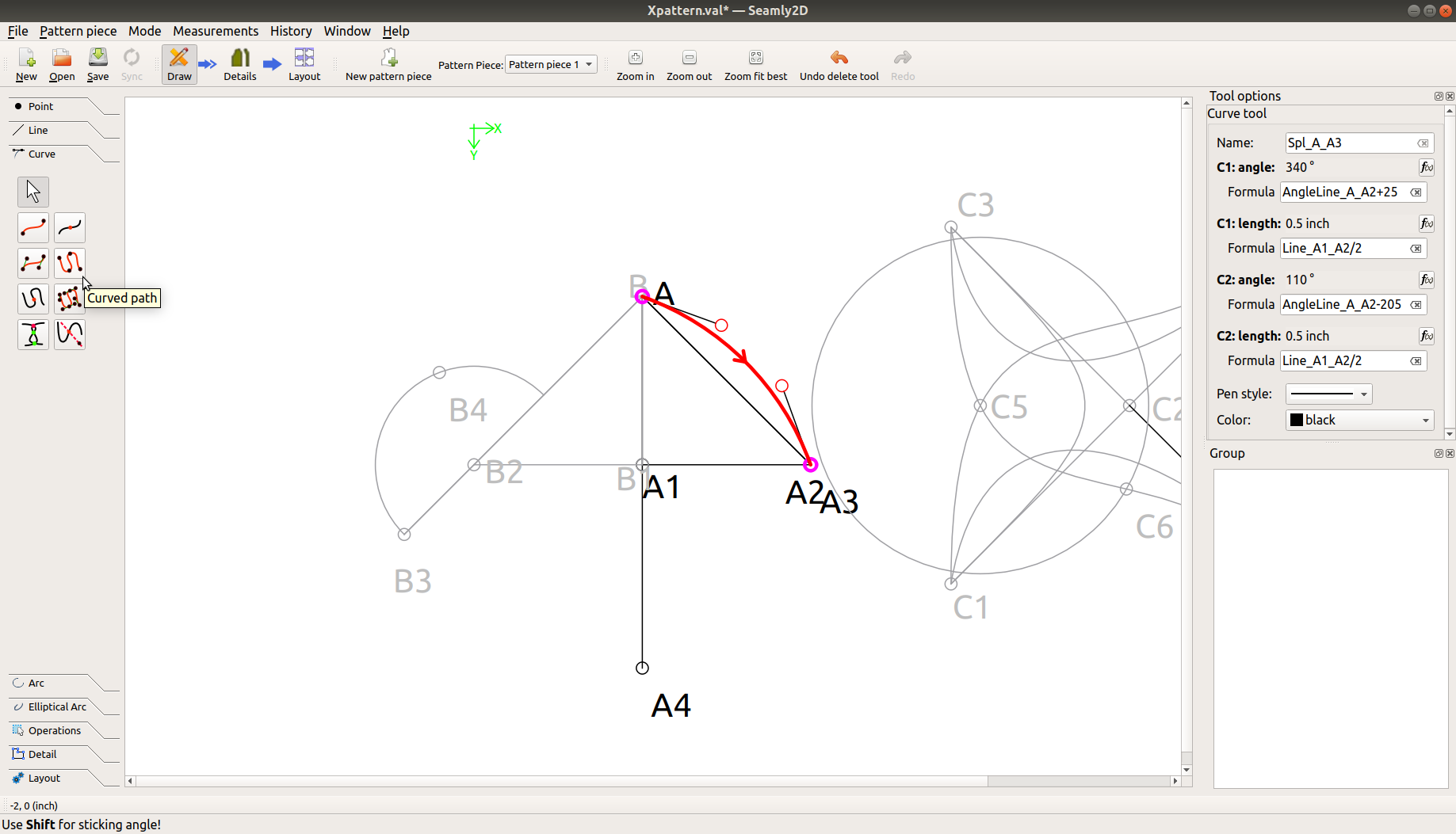

Assuming that the dart curves are supposed to go through A12 & A13, you’ll want to use the “Curved path” tool; it’s the squiggle with four (4) black dots.
However, it looks like A12 & A13 are farther apart in the picture using your measurements, & they’d need to be a lot closer together not to reverse the curves’ directions.
It might also help to make the curves’ angles in relation to the angle of another line, such as I did in this experiment:
It should be noted that I used a “Simple curve” to make that curve, but am pointing to “Curved path”. If you can’t see the entire picture, with the curve qualities filled in, just click on it & it should open as an overlay.
You’re right. It appears that my curve went from A6 to A10, even though it passed through A12. Thanks for pointing that out. Is there a better way to make that connection so that it includes all three points?
Never mind, I think @Pneumarian had a suggestion using the curved path tool. I am going to try that and see if it works better when I scale it up to my size.
