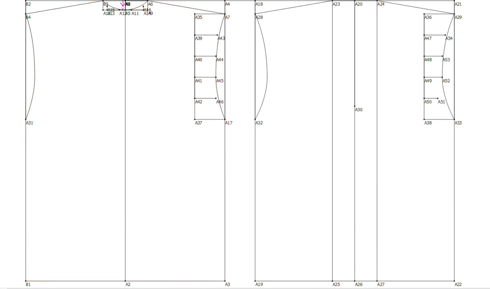

But there is two pattern on the block. Back Body Pattern and Front Body Pattern.
After tracing the Back Body Pattern (B1, A31, Spline A31-B4, B3, Spline B3-A6, A7, Spline A7-A17, A13) how do I continue to the Front Body Pattern?
While drawing block we continue to drawing and use invisible pen on the line linking the two pattern but maybe here It may cause problems since It adds Seam Allowances etc.

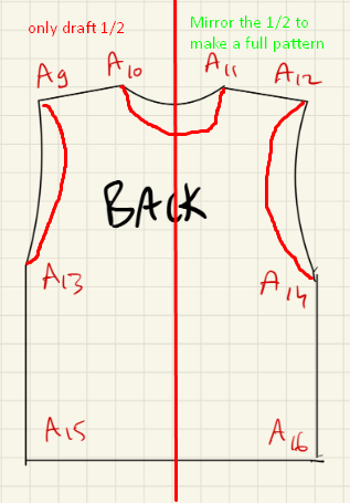

I would like to reply to you, but your pattern making methods are way above my experience. I would have only drafted a quarter of the pattern, given it 2 necklines, created a pattern piece for the whole quarter with one of the necklines and then another pattern piece for the whole quarter using the other neckline, and then printed the pieces.
Then I would have folded the fabric in half, placed the center line of each pattern piece on the fold of the fabric and cut it out.

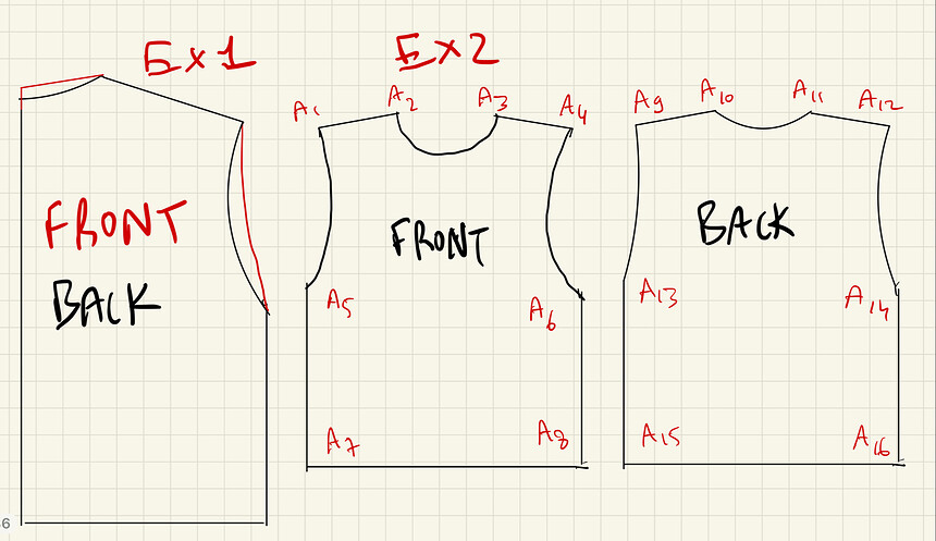

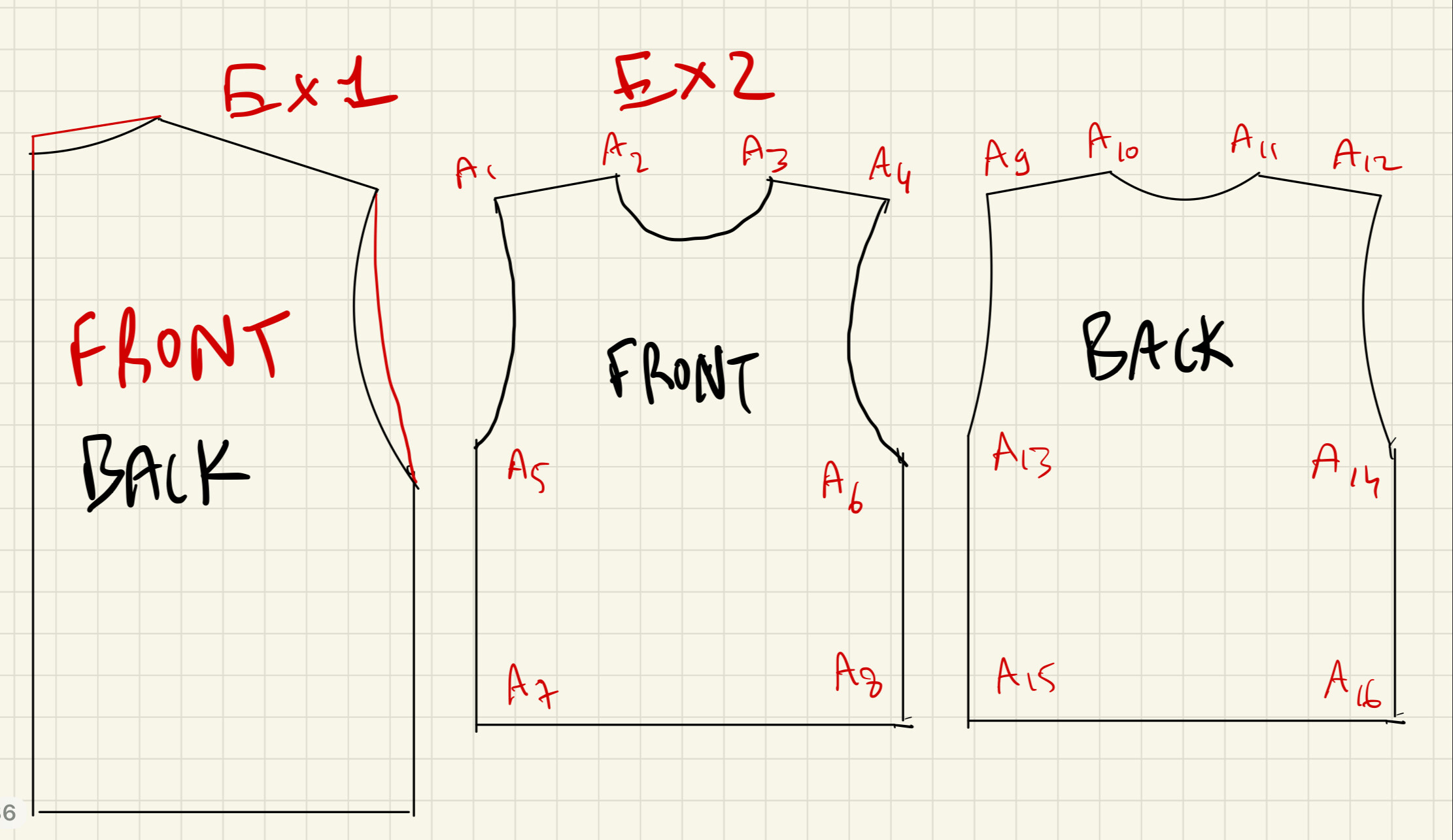

I send my patterns to workshop. They can’t deal with folding the fabric then cut and unfold, etc. So I work on full patterns.
You work like on the example 1. I work like on the example 2.
Both patterns are on the same block.
So how do I trace the back pattern after I trace the front pattern?

@optimusprime93 Maybe I misunderstand your question, but my interpretation of what you’re asking for is this:
You can create multiple pattern pieces from a single draft block. You can click on the green plus sign in the Piece tool group in Draft mode to create new blocks.
You can use the same side seams and hem line for your Front and Back pattern pieces, and switch out the armscye curves and neck curves.
