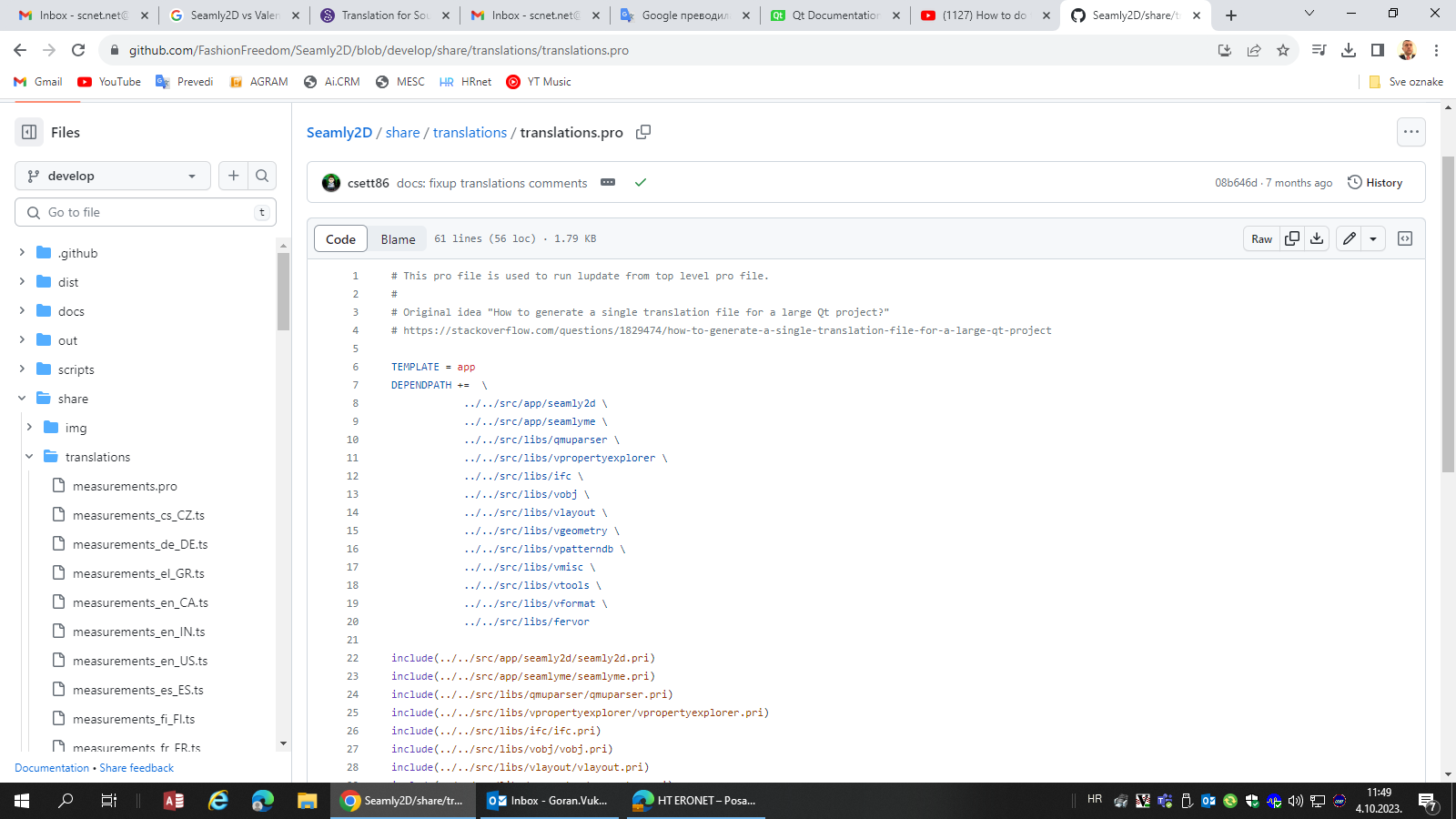

you can add the language to the file share/translations/translations.pro
and create the files seamly2d__.ts
(if you have done the checkout from GitHub - FashionFreedom/Seamly2D: Open source patternmaking software to democratize fashion. )

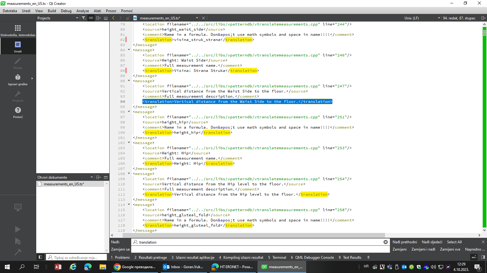

You should be using Qt Linguist to edit the translations. Don’t directly edit the xml. You can use the standalone version.

Both, but you have to be careful with the measurement ts as the measurements have a specific format
Also note that you should name the ts files with the correct ISO locale code… for Croatian it should be seamly2d_hr_HR.ts and measurements_hr_HR.ts. Not sure which code to use for Serbian.

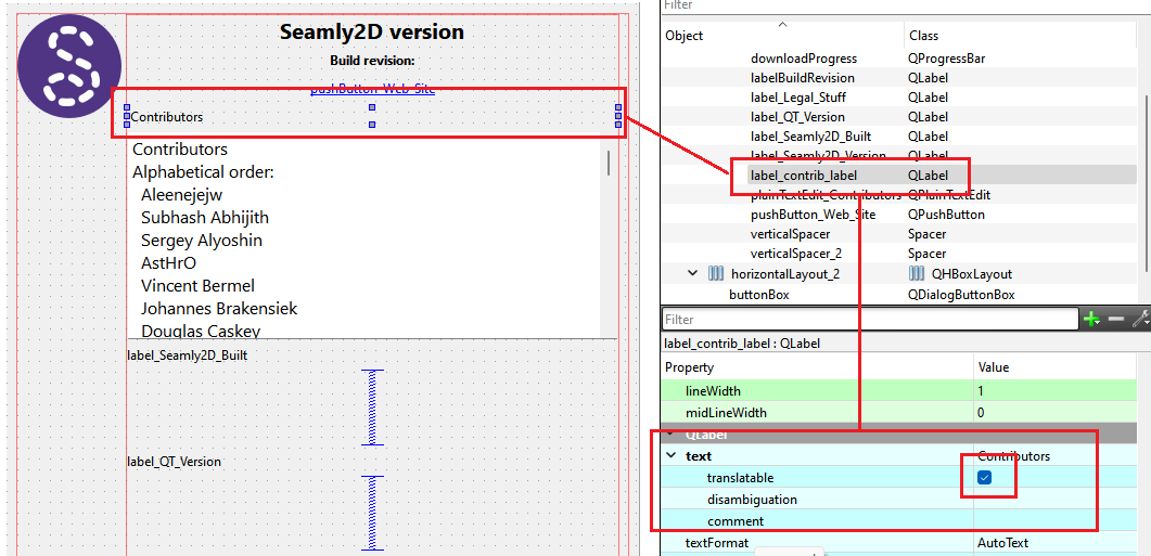

That’s the “context”… or more specifially which source ui form file. For example… take the DialogAboutApp
context
It corresponds to the Seamly About dialog, which is generated by the dialogaboutapp.ui file
about
So if you look at the “source texts”… you will see About Seamly 2D… which is the Dialog title. So any ui text string that’s been checked with the TR attribute, it will generate a translation string when ever Lupdate is run. If new additons are added to the form, a new text string will be generatedin the ts file. If a ui text is deleted, the text string is then marked “vanished”… meaning it’s no longer in the form. One can run Lupdate with an option to remove “vanished” or “obsolete” text strings.
So take the text string “Contributors”… that is the label_contrib_label in the About form. When you look at the form designer in Creator, you will note it’s checked to translate. What happens then when you switch languages, the app then uses that language’s qm file to change all the text strings… so if you were using the Spanish translation the label text is replaced with Colaboradores.
That all being said… while it helps knowing what form a text string is in, it shouldn’t matter translating, unless there may be something ambigous about the text where it helps to see the context. Translators that work throuh a service like Transifex, have no clue what the app is, they just deal with the ts file, whether it’s through Linguist or another app.
Since I did some checking - I need to expand on this… since the measurements are actually variables there are tests that are built and run to check the validity of the locale & translations. The tests will check for things like the system code, locale, comparing the regex of the orginal to translated names, name uniqueness, or if the translation string contains a LF. The tests use a defined list of supported locales… so it’s not just a simple matter of adding a new measurements__.ts file and adding it to the translations.pro. The translation file list also has to be updated with the new locale. If a new ts file is added without updating the list, the test (and build) will fail as the number of ts files does not equal the supported locales. It’s a check to make sure no translation files are missing.
