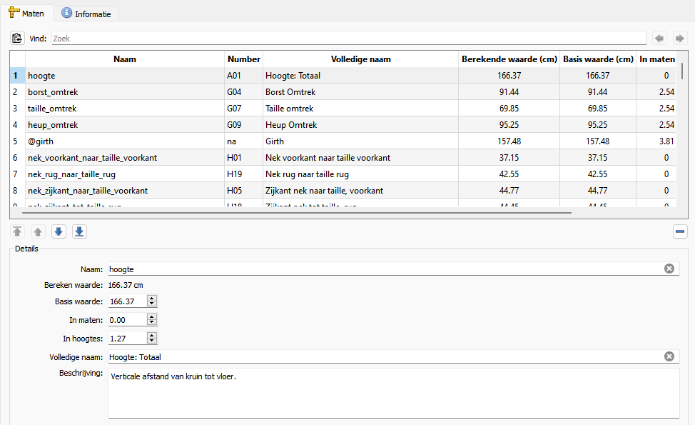

Also while I was in SeamlyMe… I fixed another layout thing that bugged me… I moved the list Move Arrows & Delete buttons up and out of the Details group box… while also widening the label space of the detail labels.
