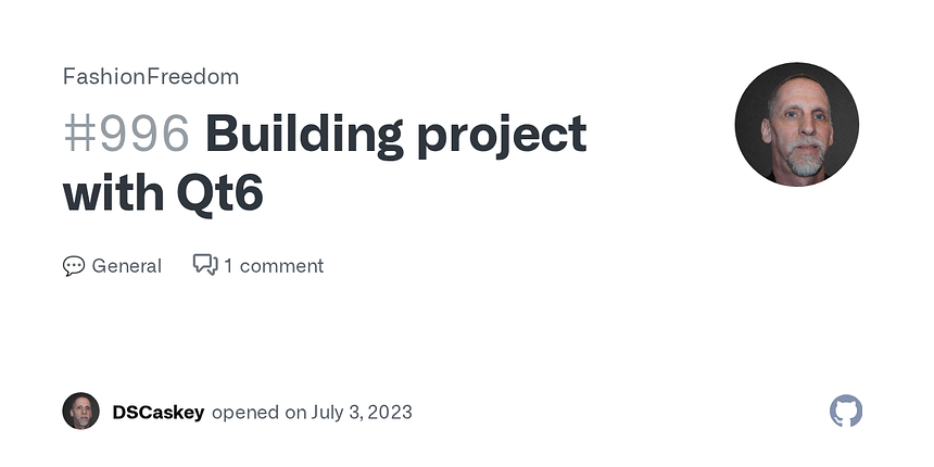

PM me if you need help guiding you through installing Qt6 and setting it up. There’s a alot of stuff you don’t need to install from the Qt maintainer. However if you want to build with the MSVC kit you also need to install Visual Studio to get the Qt tools. Since using Qt6 I haven’t built with GCC, but I don’t see it as an issue. When using the MSVC kit there’s also a bunch of environmenal variables that need to be set… which I had to search all over the place to find what to add as it was rather obscure info. I added a disccusion awhile back that outlines the addiitons that need to be made. It’s for Qt 6.2.4, and we’re now using 6.5.3 so you just need to replace references to 6.2.4 with 6.5.3.
I’m glad I did that wayback when as I’ve had to refer back to it when we actually migrated to Qt6.5.3.
