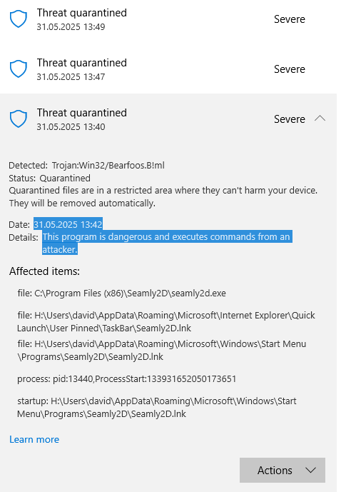

I just got Seamly2D update (latest version on the Forum) and got this ‘Severe’ threat warning in Windows:
Windows just deletes the executable(s) without any other options to ‘allow’ the execution (which I wouldn’t do anyway!). Anyone heard of this? There are Web references to a ‘catch’ by Kapersky, but that was an older contribution.

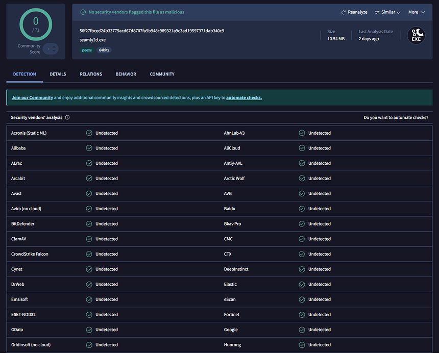

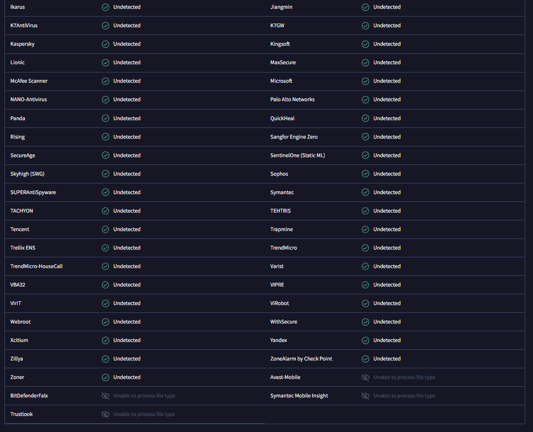

Yes. The .b!ml extension indicates it’s a detection of a machine learning detection engine of Microsoft Defender, and most likely is a false postive. It’s been flagging seamly2d.exe on and off for awhile. I installed last mon’s release on wed, and it ran fine. I just ran it now and Defender flagged and quarantined it? I restored it, and ran a Defender scan on the folder. Nothing was detected, and it now runs fine again. I also just scanned seamly2d.exe with Virus Tool and none of the scans detected anything:

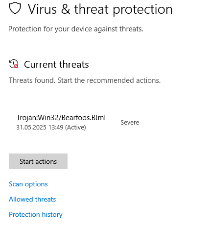

I got the same a few minutes ago. I clicked on the Severe at the Threat Quarantined & selected Allow. Then I clicked on the Actions and selected Re-instate (or something like that).
