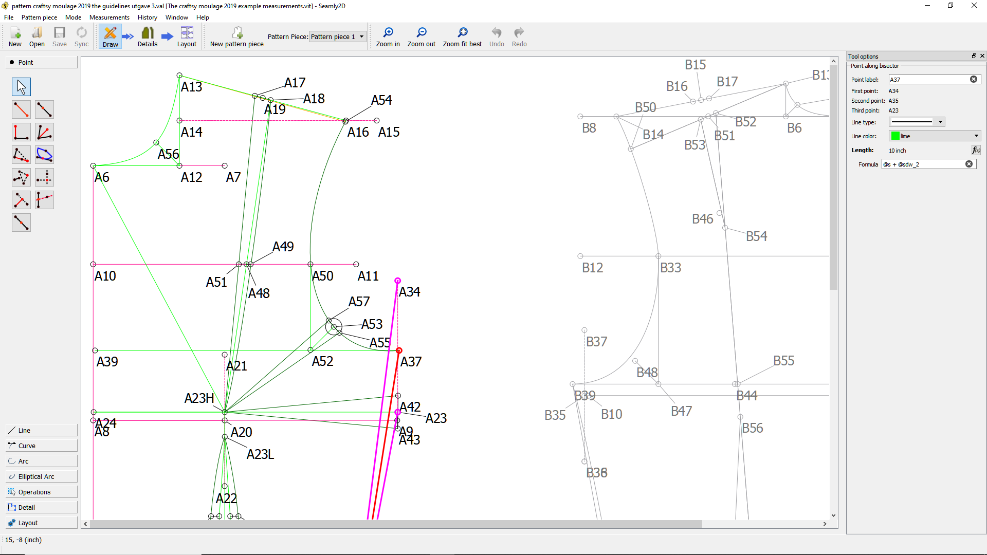

I have been drawing up a moulage, and put in a lot of work. But when I am grading my pattern with new measurements, I see that have made the point A37 wrong, so I want to delete it. But I can’t seam to delete almost anything. I have also as I read in an answer somewhere else in here, to delete everything in detail mode and then start delete from the most recent point - but even this point won’t be deleted. Really don’t hope I have to start from the beginning…

It seems that the armhole curve ends at point A37 and there may be a lot more dependent on it as @dogwooddenim says. Is there no way that you can correct the way that you created it? Either by changing the formula or by changing the nodes that it is dependent on?
By right-clicking on the node, select Options you can change the node dependencies:

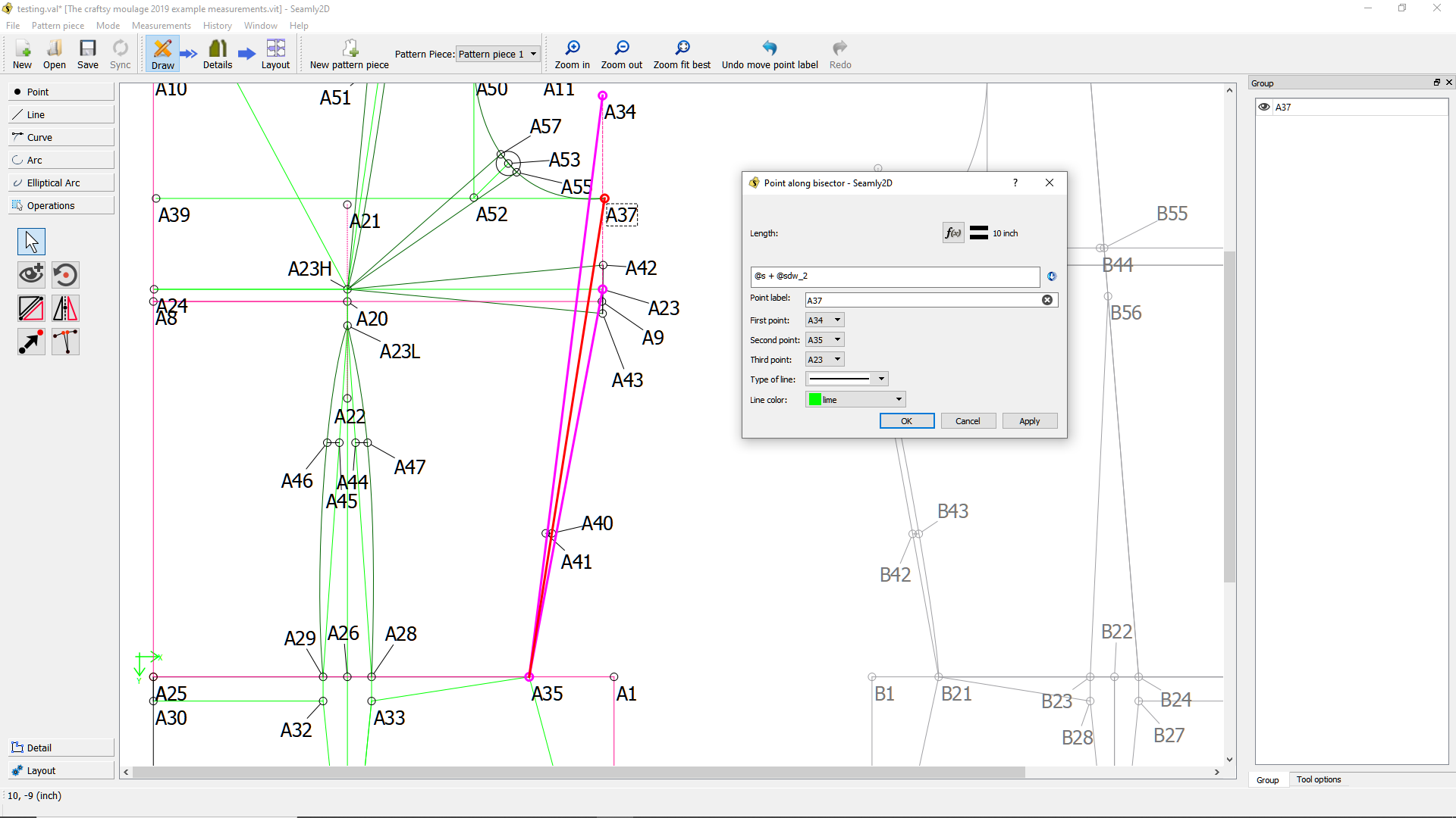

When I look into it, I don’t think it will be enough just to delete A37. To me it looks like there are several things it that area that is wrong. My intention when I drew it, was to draw a line from the point A35 (down at the waist). The line is going to be the measured side length + side dart width, in this case a total of 10 inches. I was trying to make it so my new point A37 would a created on the guide line A23 - A34. I thought I managed to do this by using the tool “Point along bisector”, but I see now that the A37 is off the guide line anyway, so this obviously was the wrong tool to use. And when I update the measurements it is totally of. So I will try your different suggestions of deleting it, but do you have any methods on how to achieve what I am trying to do?
Yes, use the tool Point at Distance Along Line and enter your formula:
(I just used 10" x 2.43 because I work in CM, but you can use your actual formula.)
Do this back in History just before where you originally created the A37 node:
When you have created the node, save your pattern, go back to History drag the scroll bar down to the bottom & click on the last line so that anything you create further, will automatically be added at the end again. Perhaps even close your program and reopen it to be sure. Don’t forget to create a Save as copy before doing this.
Then you will be able to check through the history for anything that is connected to A37 and change them to the new node. You will also need to check all the formulas where you have used A37 and change them, too.

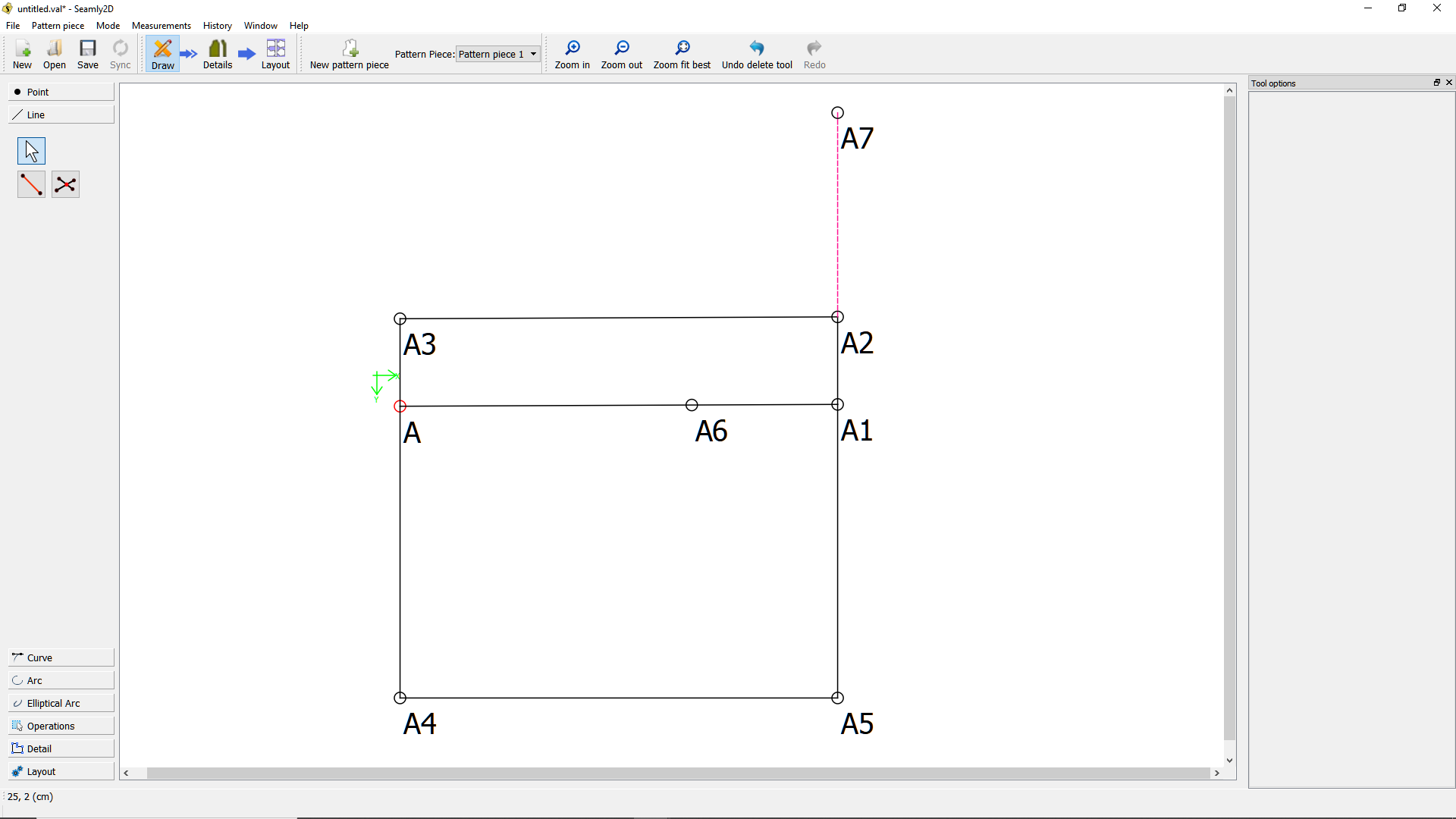

But the thing I am trying to do (and I don’t know if it is possible at all…) is to make a new point (A8) somewhere along the pink line A2 - A7. And I want the point to be placed so that the length from A6 to A8 is a given length (in my case 10 inches). Is this at all possible to do?
You might be able to use the arc tool from A6 to intersect the A2-A7 line.
Yes, @dogwooddenim is correct.
Thank you very much, this worked for my purpose!! Now I just have to see if I will manage to delete some of the necessary points and try this tool instead. Thank you very much all of you :grinning:
