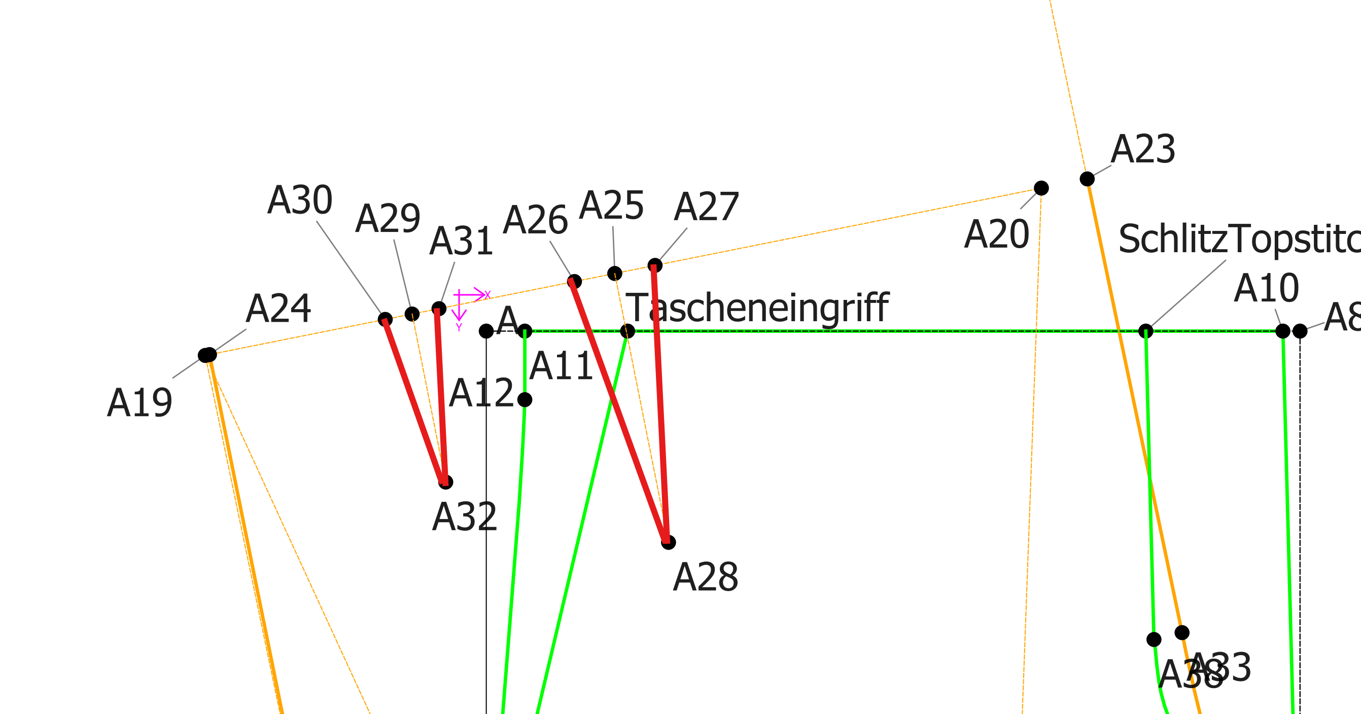

I have two darts that are located on the same edge. I think that I have to true them. At least I did that in the past, using the “True dart” tool of Seamly, and the results were good. The difference is that I only had one dart on the same edge so far.
In the following screenshot you can see the relevant part of my current pattern. I put red lines as an overlay to mark where the darts should be. How can I true both of them?

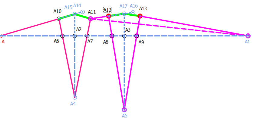

Here’s an example…
Left dart used A and A1 as the base points, and A6,A4, A7 as the dart points. The dart tool creates the new dart points A10 and A11. The right dart then used points A11 and A1 as the base points, and A8, A5, A9 as the dart points. It creates the new dart points A12 and A13.
I then extended Line_A_A10 to A14 usinf the angle of Line_A_A10. The using the intersect line and axis tool found the intersect point A15, and connected A10 to A15 and A15 to A11.
Repeated the same with the 2nd dart.
So when tracing the pattern piece I would use points A, A15, A11, A17, A13, and A1. Darts could be added with internal paths A10, A4, A11, and A12, A5, and A13.

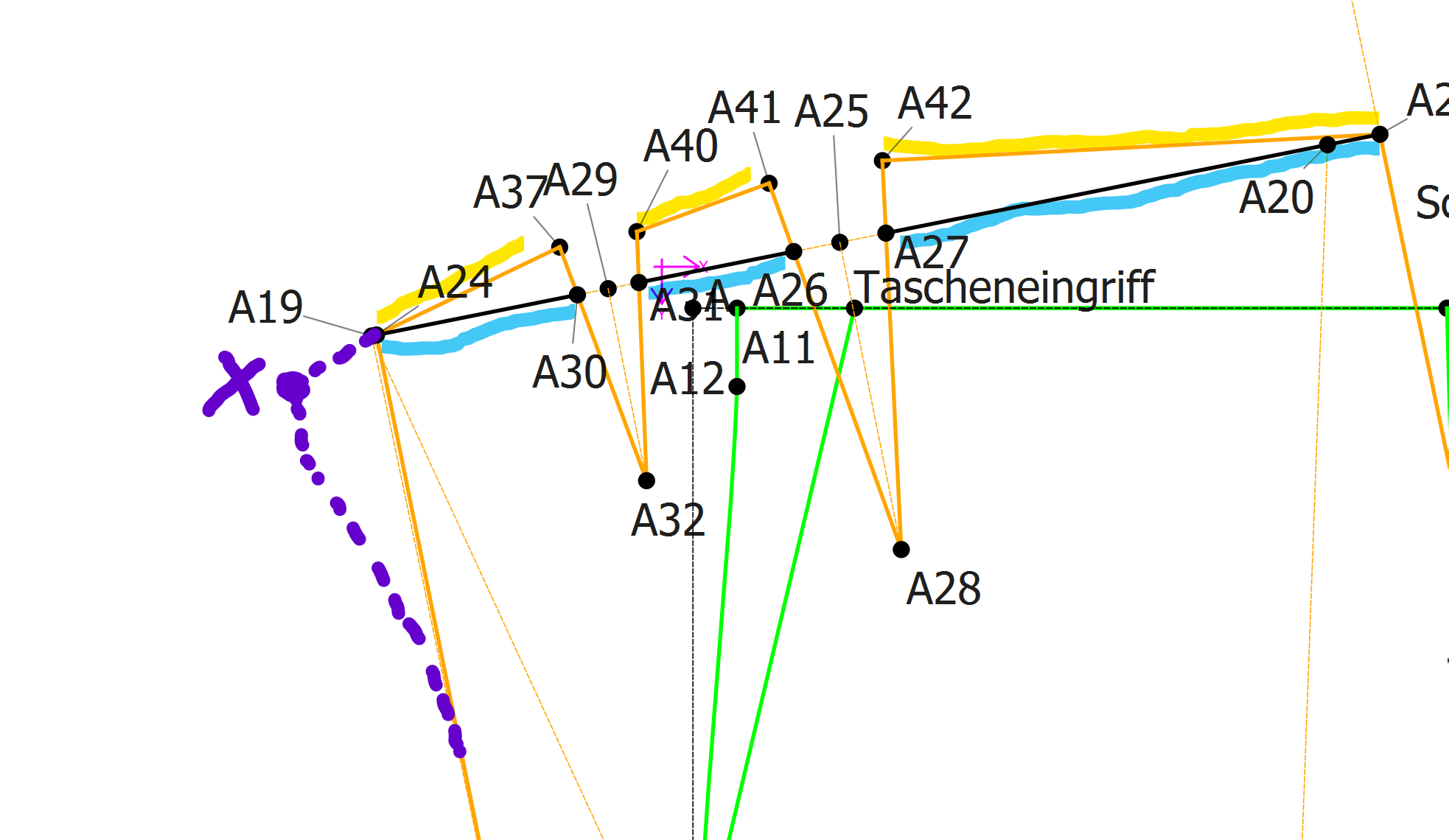

Thanks a lot @Douglas , that worked great! I adapted my pattern and quickly tried out the result with paper. The edge is now perfectly straight after applying the darts.
I noticed that the new edge (marked with yellow in my screenshot) is now significantly shorter than the “old” one (light blue):
Yellow: 21.5cm
Light blue: 22.1cm
Since this is the back of a trouser, 0.6cm missing would yield 1.2cm missing on the waist. Am I correct?
Is there a standard procedure to accomodate for that? I sketched in purple what I would do naively: Adapt the pattern with a new point X. Length of line X to A24 would be the difference between the blue and yellow lines (so 0.6cm). Then smoothly blend it in again with the original perpendicular line from A24.
I could just make the darts smaller right :smiley:
If you’re making custom pants I would just add at the center back seam 1-2 cm for the base length. Your normally going to close the back seam up to fit the waist anyways. It’s always a good idea to have a litte extra seam allowance on the back seam anyways.
Since I was always making pants for costume rental, I always added an inch on each side of the CB seam to allow a couple inches of alteration.

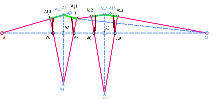

Hmmm. The True Darts algorithm needs improvement. This throws off our claim to have seams that don’t need walking.
We could always adjust the tool to produce something more like this:
It would be also be nice to produce 3 points instead of 2 so one doesn’t have to construct for ex: points A15 and A17.
Yes this would fix the problems with this tool.
