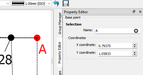

If you draft the front and back in 2 different blocks, you can move a block by clicking and holding the left mouse button on the base point (it always the red colored point), and dragging it. You can also move or refine the position of the base point by editing the x:y coordinates:
