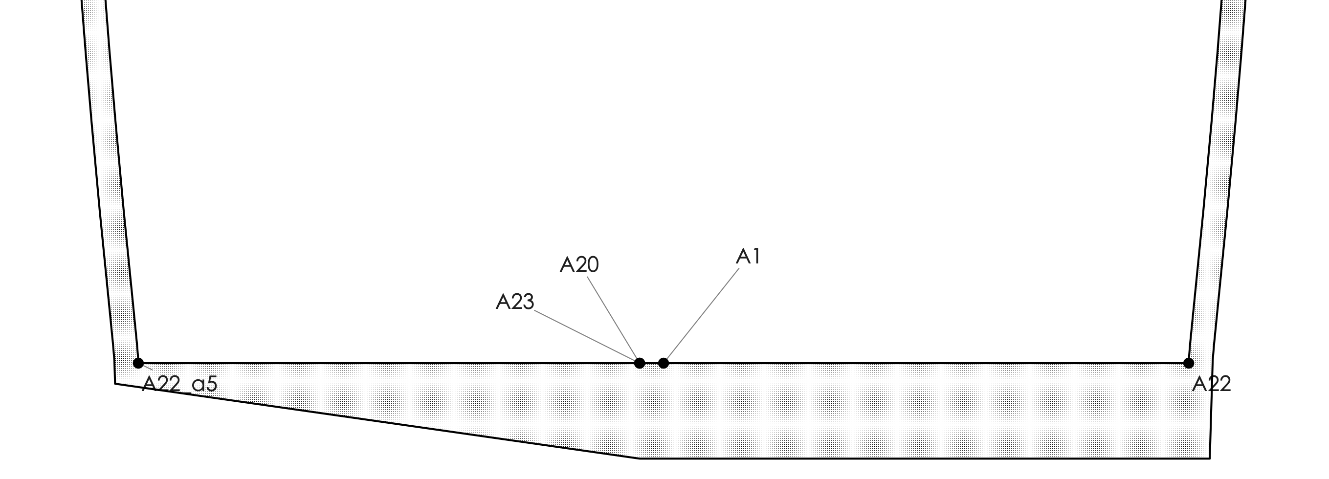

i added a point next to the point i want to jog down from and now it doesn’t seem to change when i pick different angles.
2024 gala dress.sm2d (25.3 KB) emily 110424.smis (1.2 KB)

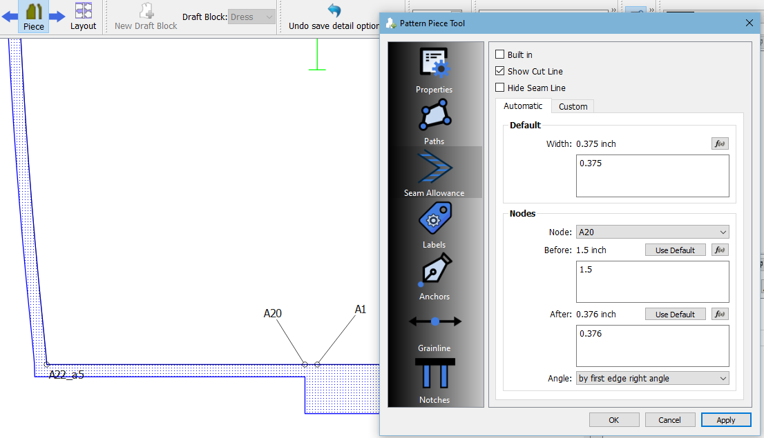

You can remove the extra point (A23) because it’s not necessary.
At point A20, just add or deduct 0.01 from the After amount and set the angle to 1st or 2nd edge symmetry:
Technically we should be able to eliminate point A20 as well, and assuming one may want the 3/8th SA as thesecond edge symmetry… but we can only get a 0.0 SA or a 1.5 SA regardless of whether 1st or 2nd symmetry is selected.

Since it doesn’t work the way we’d want, we have to add that second point to fudge the allowance so it falls on center.
I think the SA “Angle” needs some work. :roll_eyes:
