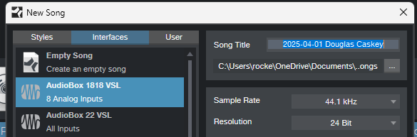

Certainly we could add templates to Seamly2D. However at some point you have to name the new pattern. Typically an app may give a project a default name that you can change before you load a template… for ex: here’s my audio editor where I can start with a template, with the choice to name the new Song other than the default:

Ahhh. yes - if we did it this way. We basically have 2 choices… all of which require a “Save as”… just depends on when it’s saved. 1) Give a template a new default filename, and after editing saving will perform a Save as as the new file does not exist yet. 2) Basically copy (Save as) the template with a new name up front (which is what my DAW does).
In other words… loading a template will require making a copy - i.e. a Save as with a new name. It’s just matter do we want to do before or after making changes. Also keep in mind, that a pattern may have image files linked with it… which is some else to consider when loading a “template”.
