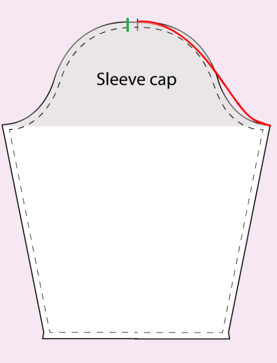

Technically… it depends. The back side of a sleeve needs extra room for the shoulder blade, so the back half of the sleeve is usually shorter… which may be offset if the shoulder notch (top of the sleeve cap) is moved forward (green line) to meet the shoulder seam of the bodice. In the pic below the red line indicates how a 1 piece sleeve cap is adjusted on the backhalf:

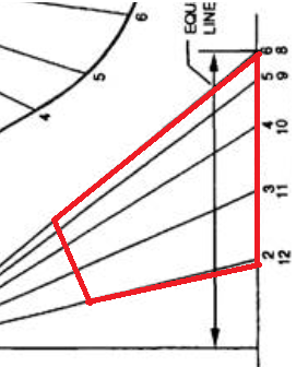

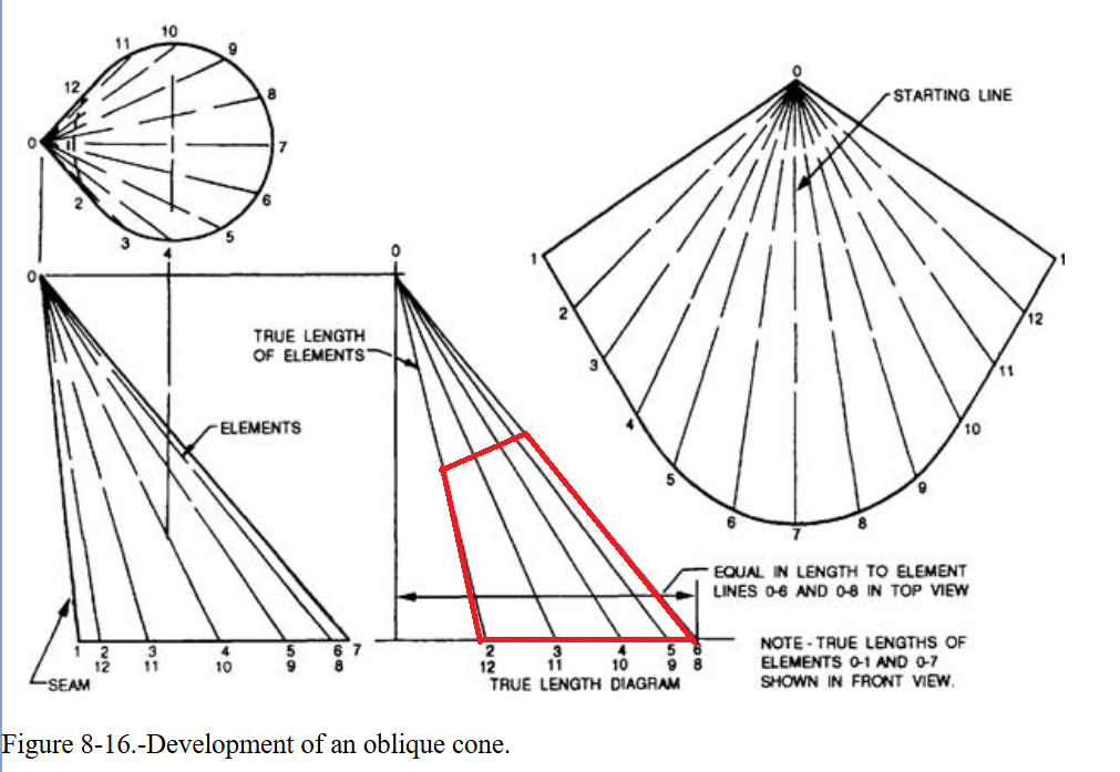

BTW… for anyone interested… a sleeve pattern is more or less a truncated oblique cone. We had to draft this sort of thing waaay back in 7th grade drafting class.

Well that’s why I qualified it with “more or less”. A T-shirt sleeve would be more… a jacket sleeve - less so. :slight_smile:
