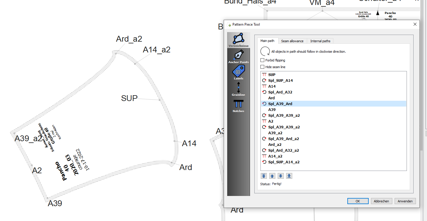

Im Pattern Peace Tool kann man an Hand des zuerst genannten Punkt sehen in welche Richtung die Kurve läuft.
Die Kurve der Seitennaht müsste von Ard nach A39 laufen, damit sie richtig dargestellt wird. Im Fenster sieht man aber das die Kurve von A39 nach Ard angelegt ist. Also muss ich sie umkehren.
Understood, but my point was this does not indicate which points need to be reversed, it only shows which curves HAVE been reversed. That’s the point of @AnnaFields original post… that some curves needed to show counter_clockwise while others need to show clockwise… mistakenly thinking all curves need to showclockwise.
The idea is if I can have the app determine which curves NEED to be reversed when added to a Pattern Piece path, then there would no need for a user to do so, and subsequently no need to show that a curve has even been reversed.

I think that it’s perfectly clear that the counter_clockwise shows that the orginal state of the curve has been reversed for the purpose of that pattern piece, so I really don’t see an issue there.

Yes, but if you reverse a clockwise curve the counter_clockwise will display to show it’s been reversed, but the curve is now counterclockwise and won’t display coreectly, and on the same token if you reverse a counterclockwise curve the counter_clockwise will also show, but this time the curve is clockwise and displays correctly. Again the icon is displaying state, not direction - which I admit can be confusing.
