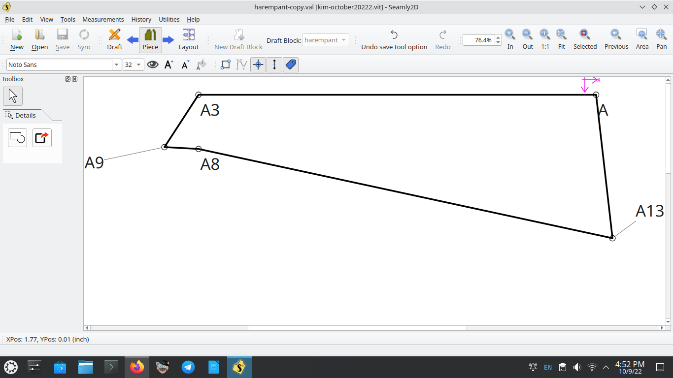

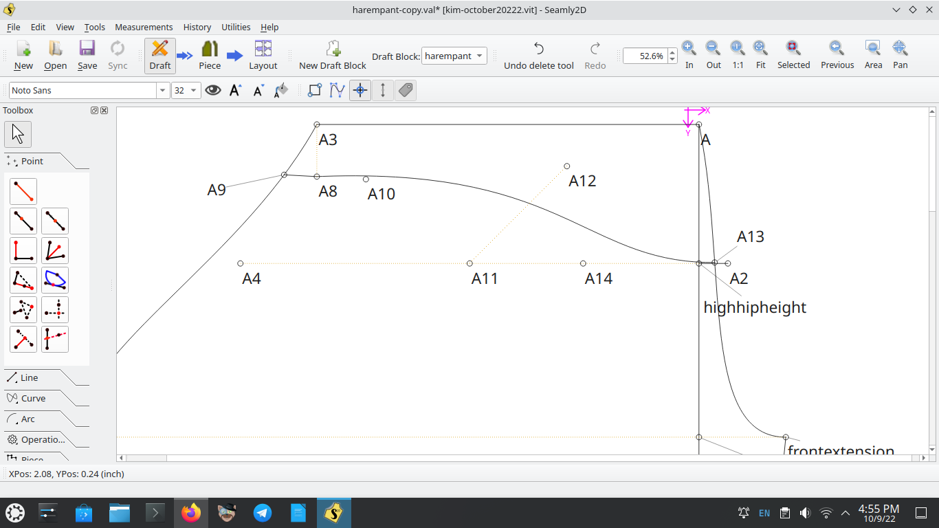

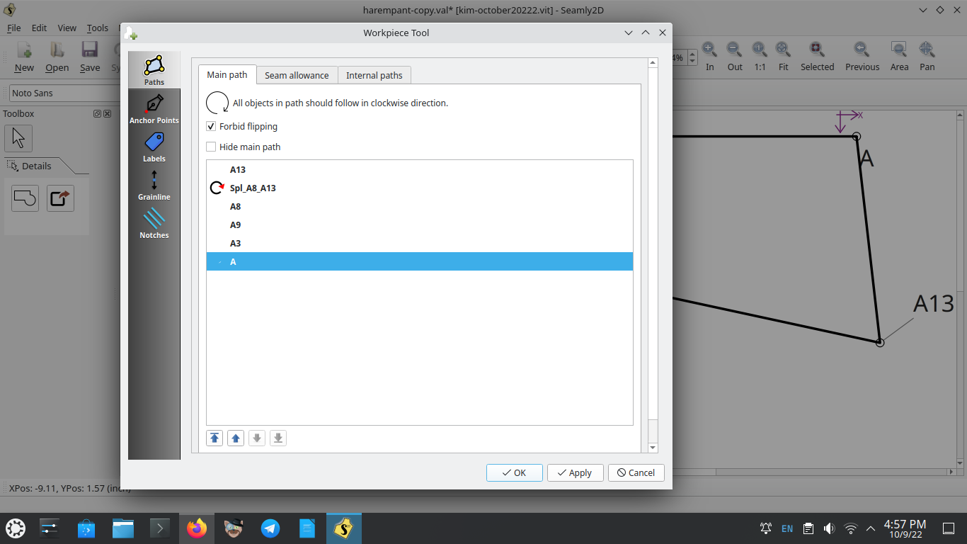

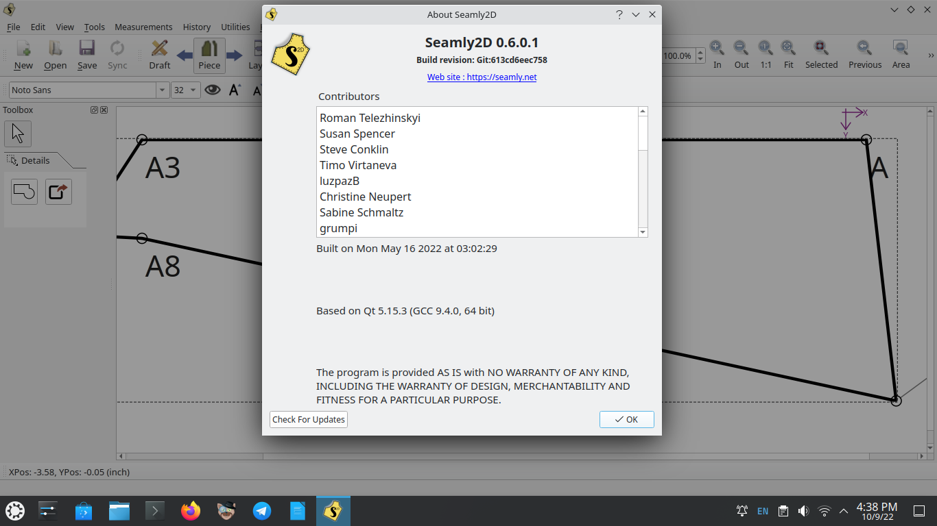

I am creating a curved waistband for a pant pattern for a class. I have figured out how to use control points to shape the curve the way I wish but when I try to select the curve as part of using the piece tool in draft mode I have been unable to select the curve. Instead I end up with a straight line when I go to piece mode. I am using the latest appimage version I could find on your GITHUB site. I am including a screenshot to show the version. I also include the .val file, .vit file, and 3 screenshots to show the issue. I really hope that someone can tell me what I did wrong. thanks in advance. @Grace is a genius and I hope you can help. Now I will figure out how to post the screenshot files. Please pardon me, it has been a very long time since I used the forum in this way

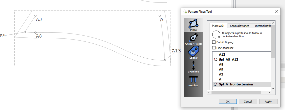

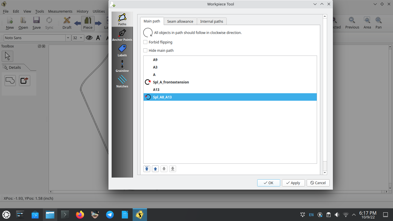

I solved this myself. It turns out that the everything must be clockwise rule does not work as I thought it did. I am not sure why this works and it is probably something @Douglas will want to look at eventually. I used the shift key to select a spline which I understand is supposed to correct for the clockwise vs counter clockwise direction. I am attaching one more screenshot, which shows that I include 2 splines in the pattern piece and one must be clockwise and one must not be. I have no idea why this works but I have solved my problem for now.

Yes, it’s a simple matter of holding the shift key down while selecting the curves that are going the ‘wrong’ way, or editing the properties in Piece Mode to reverse them.
Please note that there are actually 3 curves, 2 of which need to be reversed :slight_smile:
@Grace I understand the bit about the shift key and reversing the curves. What stumped me is that the final thing that actually worked and transferred the curve to the piece mode has one curve (spl_A_frontextension) clockwise and another (spl_A8_A13) counter clockwise. I played with it until it worked. I do not understand why it worked this way. Please see the last screenshot which shows the items included in the piece. I did not include a screenshot that shows the piece as it should be. The piece to which I refer is labeled “waistband”. It is the only fancy design detail on these pants, which are just a comfortable kick around pant that I am using in my sewing class this week.

Oh, I see… Yes, if the curve needs to be reversed, then it doesn’t always want to select the curve if you’re not holding down the shift key. I see what you mean. It selected the curve A9 to A3, which also needs to be reversed, and it accepted the curve A to A13, which doesn’t need to be reversed, but it didn’t accept the curve A8 to A13, which needs to be reversed. But if you hold the shift key, then it does select that curve.
Ok… I took a look, and I believe I know what the issue is, and what I need to fix.
It’s more or less a case of misleading icons. There’s nothing wrong with the pattern… as per the included screencap.
What I think is misleading is the clockwise, counterclockwise icons do not necessarily represent the direction a curve is going, but rather is it reversed or not. Clockwise means it is not reversed, counterclockwise means it is reversed. So for ex, if you take a curve that is counterclockwise, the icon will display clockwise, unless you reverse it, where the icon will display counterclockwise - and the curve will work.
What I think I did was just replace the original code with an icon vs the strikethough text whether a curve was reversed or not, and not correlate the icon to which direction the curve was going.
I think (now that I understand the dialog better) what we want is the icon to show which direction the curve is going… any counterclockwise curves would then easily be identifiable as needing to be reversed so that they all go clockwise.
