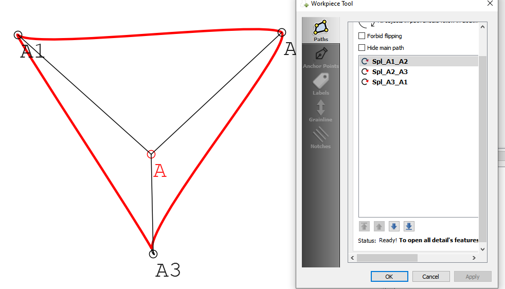

Right. <1 point. If I include a small circle as a marker in my draft, I have to select both the arc & a point for Seamly to accept it. I recently, (possibly for this thread,) tried tracing off a piece with zero points, only three curves, & Seamly wouldn’t let me OK it, I had to go back & include a point.

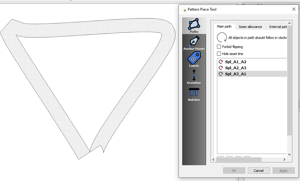

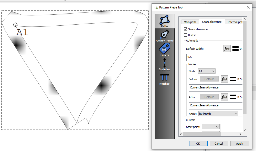

Well I tried… 1st I used an older ver pre validating the before & after. It allowed just 3 curves, no nodes:
But as you can see the formulas show error - which could result in other issues elsewhere such as the other thread. 3curves2

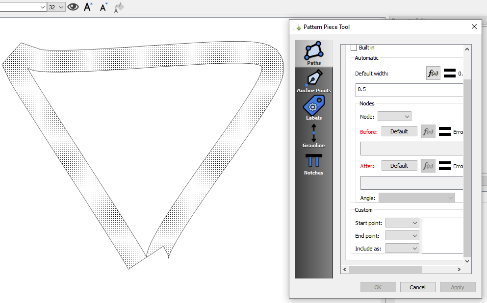

Then I loaded it into my current build, where while it allows the dialog to open, since now the formulas are being validated, the OK button is disabled.
Then I added a point node and it enables OK, as the before and after are valid.

The point nodes allow you to change the seam allowance width. If you don’t include any points in the path - more on that later - the seam allowance for the curves is simply the default (CurrentSeamAllowance).
Versions before I fixed the before and after SA formulas allowed you to create a pattern with no points. The current ver requires at least 1 point to work. I have made it so that you need to make the 1st node a point, which you can then later edit to exclude or delete the point, as it is no longer needed to establish the direction of a curve if it is the 1st node, or as the case is, the second node. Note the excluded point A1, but you can now click OK.

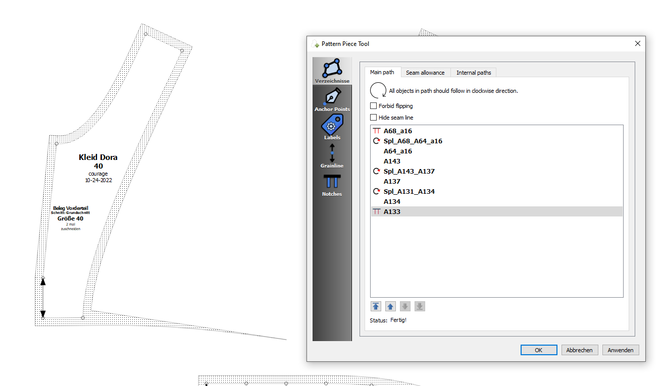

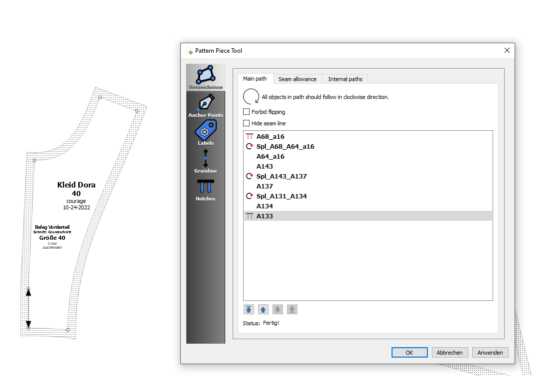

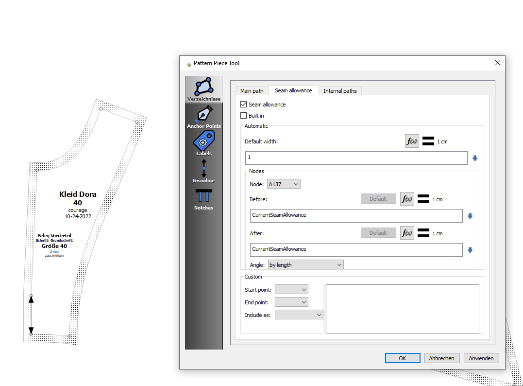

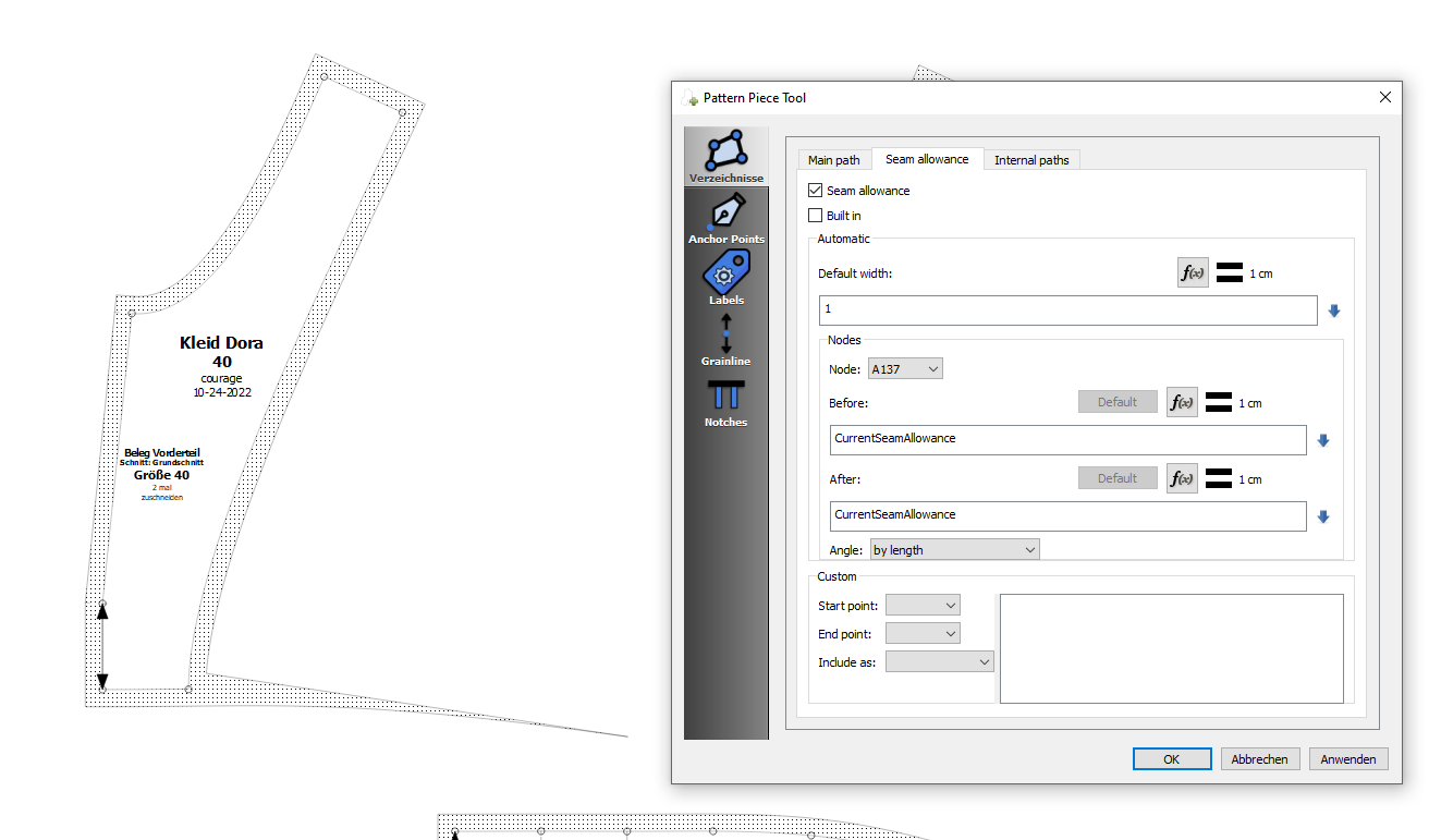

Wo wir gerade bei Kurven sind: Ich habe eine Ausgangsdatei, die ich mit Speichern unter für eine Kundin neu angelegt habe. Ich habe alle Änderungen für die Kundin gemacht und wollte dann den Schnitt ausdrucken. Im Peace Modus hat sich dann bei den Nahtzugaben der eine Punkt verändert und haut mit der Nahtzugabe ab. Wie kann das passieren? So ist der Ausgangsschnitt:
Das kam dann nach “Speichern unter”
Wie man sehen kann sind alle Eingaben identisch, aber das Bild der Nahtzugaben hat sich verändert.
