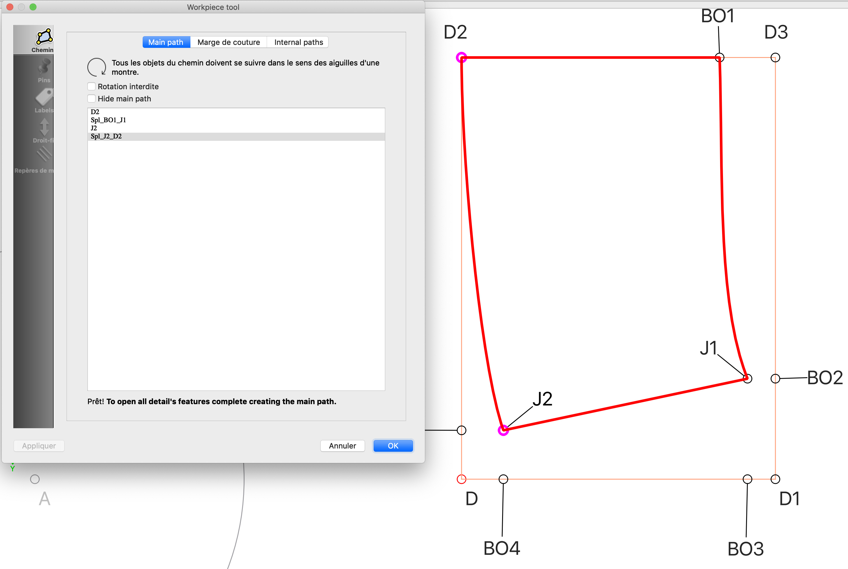

Hi, Do you understand why I can not create my boss pieces? I’m going clockwise. the curves are going in the right direction.

I think you need to select the point J2 itself, as well (and any other points in the path).
[quote=“Calum, post:2, topic:3403, full:true”] I think you need to select the point J2 itself, as well (and any other points in the path). [/quote]
The same result.

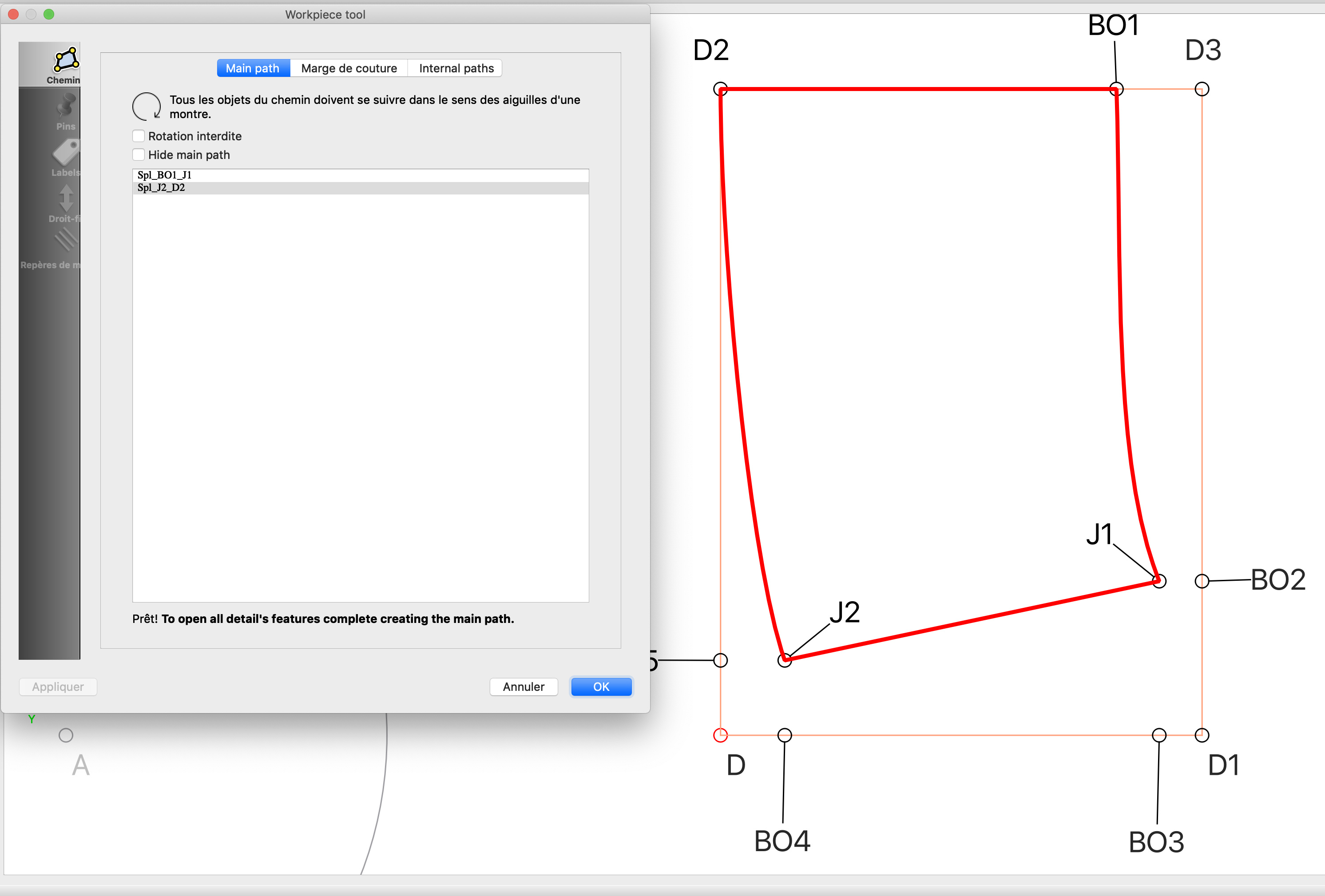

Hi, select the point D2, B01, the curve, J1, J2 and then the last curve. You need to select the point before and after each curve unless the curve connects to the first point selected.
Hi Grace, Thanks,
That’s what I do. I have the problem since the last update OS 10.14.3. Seamly, did not work anymore and I installed the latest version. I made a video of what I draw. I end with enter.

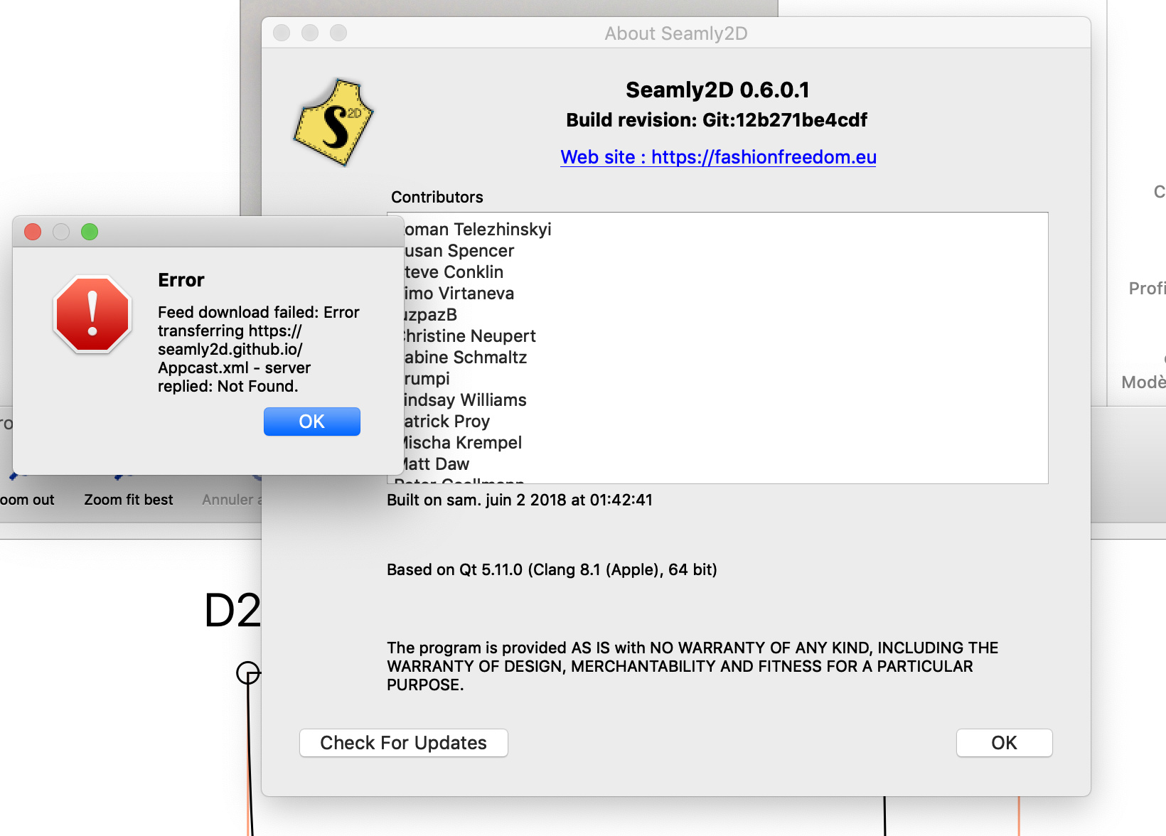

I attach a screenshot of the Seamly version. You will find that there is bug for the search for update.

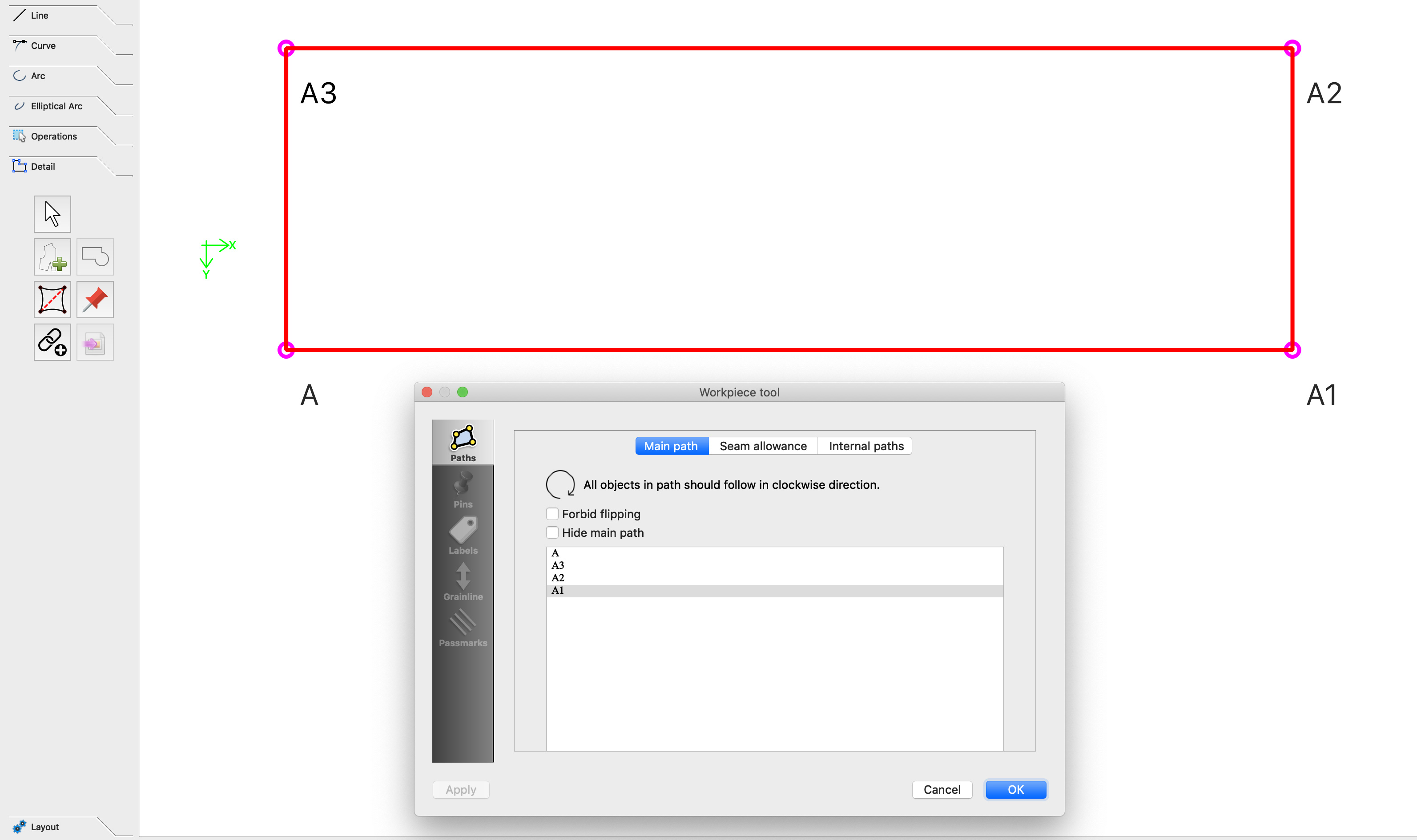

Je suis découragée! Pour faire plus simple, j’ai tracé un rectangle. J’obtiens
le même résultat. Ça ne fonctionne pas! Je vais essayer l’App avec un autre ordinateur.
I am discouraged! To make it easier, I drew a rectangle. I have the same result. It does not work :frowning: I will try the App with another computer.
Yes, the search for Updates does have a bug. It’s better to use the link at the top of this page to download the latest version, however, you seem to have the latest version.

And check the Detail board to see what is there. From your video, it is working correctly. By now, you should have a number of the same pattern parts on top of each other in the Details where you need to go once you have clicked the OK and you can then add the seam allowance, labels, etc.

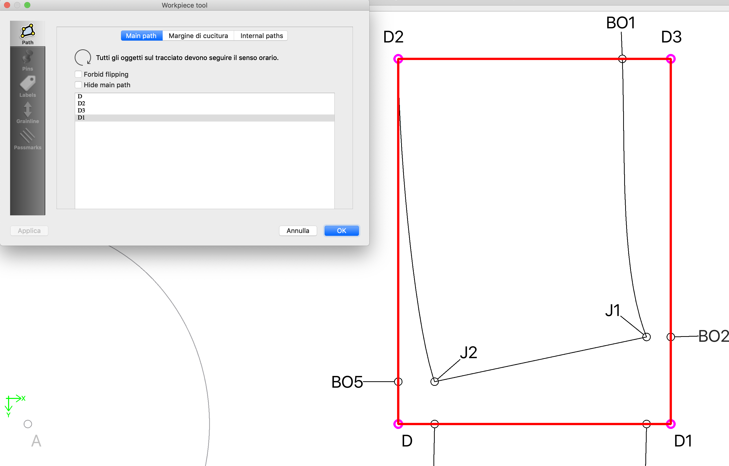

J’ai utilisé le patternA.val de @Grace , et j’ai le même problème. J’ai supprimé la vieille installation, j’ai renommer les dossiers où se trouvent mes fichiers .val. J’ai installé la dernière mise à jour de macOS 10.14.4 J’ai fait une réinstallation propre de Seamly2d, et j’ai remarqué que les préférences de l’ancienne version ne changent pas ( la langue, pattern making system, etc). C’est peut-être le problème!

English version I used @Grace
patternA.val, and I have the same problem. I deleted the old installation, I rename the folders where my .val files are. I installed the latest update of macOS 10.14.4 I wanted to do a clean a clean reinstallation of Seamly2d, and I noticed that the preferences of the old version do not change (the language, pattern making system, etc). This may be the problem!

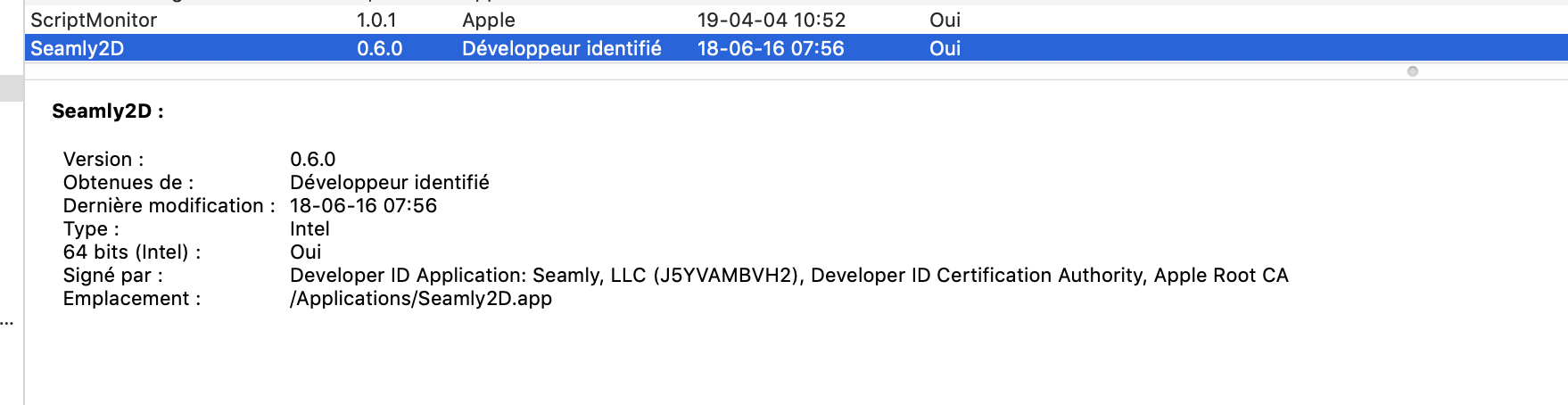

Il y a des problèmes avec certaines applications s’exécutant dans MacOS 10.14 Mojave. :frowning: There are problems with some apps running in MacOS 10.14 Mojave:
« Vérifiez si vous avez des applications 32-bit ou 64-bit installées, ouvrez le menu pomme et sélectionnez « Propos de ce Mac. »Cliquez sur « Rapport de système », puis dans le menu de gauche cliquez sur où il est dit « Applications ».Il y aura une colonne intitulée 64-bit ». Si l’application est 64 bits, il va dire « Oui » dans cette colonne. »
“Check if you have 32-bit or 64-bit apps installed, open the Apple menu and select ‘About This Mac.’ Click ‘System Report,’ then on the left-hand menu click where it says ‘Applications’. There will be a column titled ‘64-bit’. If the app is 64-bit, it will say ‘Yes’ in this column.”

So you have the 64-bit MacOS version from 16 July 2018. I’m looking into the Seamly MacOS version right now…
Thank you @Sue,
Avant la mise à Mise à jour de décembre, vers MOJAVE 10.12.2, l’app fonctionnait bien. Je l’ai testé sur mon vieux macbook (SIERRA 10.12.6) et le problème se reproduit. L’app fonctionne en 64 bits aussi. Peut-être que je fais mal l’installation ou je fais mal les tâches!
Before the December update to MOJAVE 10.12.2, the app was working fine. I tested it on my old macbook (SIERRA 10.12.6) and the problem reoccurs. The app works in 64 bits too. Maybe I’m hurting the installation or I’m doing the tasks!
