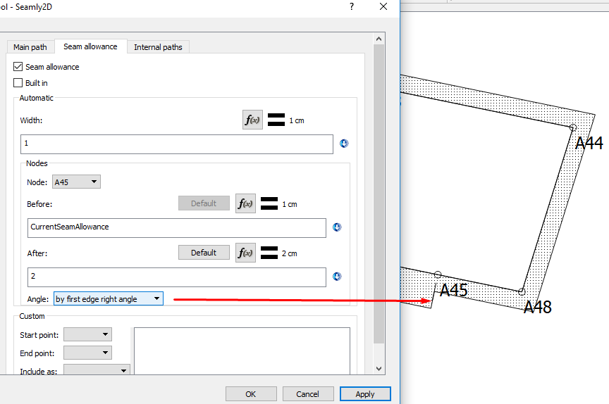

Try playing around with the angle settings - I got the following result setting it to “By first edge right-angle”:
Thats it, thank you very much! :slight_smile:

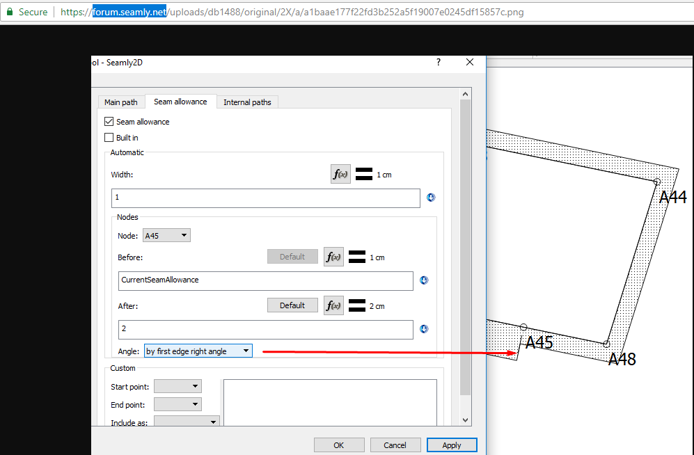

Ok, I did a little investigating and managed to find this out:
Yes, the pictures still point to the previous forum that is no longer in use. Everything has been transferred over to this forum, but the links haven’t changed.
You can see the image by changing the ‘forum.valentina-project.org’ portion of the link to ‘forum.seamly.net’.
Thank you very much for the quick reply. It is a bit troublesome to do this with every picture, but at least it solved the problem. Probably this problem is there with more old questions in the forum.
