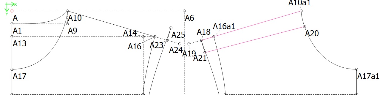

So, I tried to use union tool but I can’t unite any pieces together. Does the pieces needed to be from two different pattern pieces? I mean, I make front and back pattern on the same piece, and then I want to move the front shoulder yoke onto back pattern piece. But I can’t unite them! Here’s the attachment:

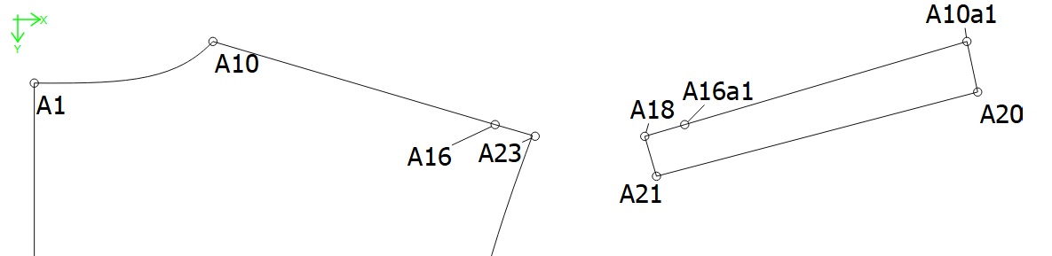

I want to unite A20 onto A10 and A21 onto A23 but I don’t know how to do it. I’ve selected the first and second point from the front piece which are A20 and A21, and then selected A10 and A23 from the back piece. Nothing happen.
Actually, I need to unite them on the draw mode because I will make a new armhole based on the new united pattern. Like this:

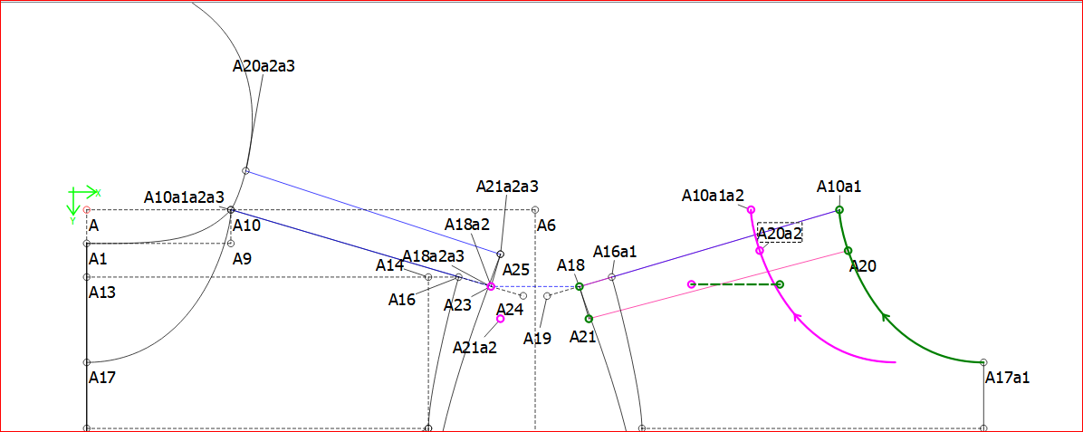

  1. Create three lines: Line_A23_A10 and Line_A18_A10a1 and Line_A18_A23
  2. MOVE the back piece to connect with the front piece. Use the Move tool. Select CTRL, A18, A10a1, neck curve, A20, A21, then ENTER. Then arbitrarily move the mouse and click anywhere. When dialog box appears, overwrite the formulas with:image
  3. ROTATE the moved objects. Use the Rotate tool. Select CTRL, A18a2, A10a1a2, neck curve a2, A20a2, A21a2 then ENTER. Select A23 as the origin point. Then arbitrarily move the mouse and click anywhere. When the dialog box appears, overwrite the formulas with: image
  4. Draw in the line between A20a2a3 and A21a2a3. It should look like this:

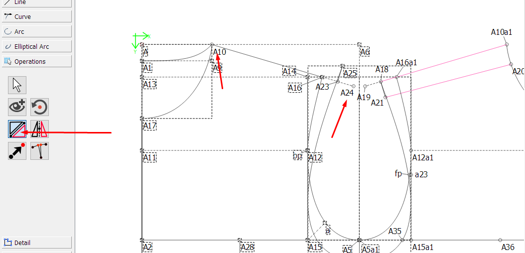

Using the “Flipping objects by line” tool, I selected all the objects on the left-hand side except the nodes A10 and A24 which I will use as the flipping line:
Hit enter to accept the selection and then select the axis line points A10 and A24.
Enter your preferred suffix for the added parts and click on OK: image
Go to the added parts and draw in the lines again, if you wish.
A quick way to select a lot of nodes and curves is to zoom out so that you can see the whole part you’d like to select, Drag a box around everything, zoom back in to the area where the flipping line is, hold the Ctrl key & click on each of the 2 nodes to be used as the flipping line to de-select them and hit enter.
