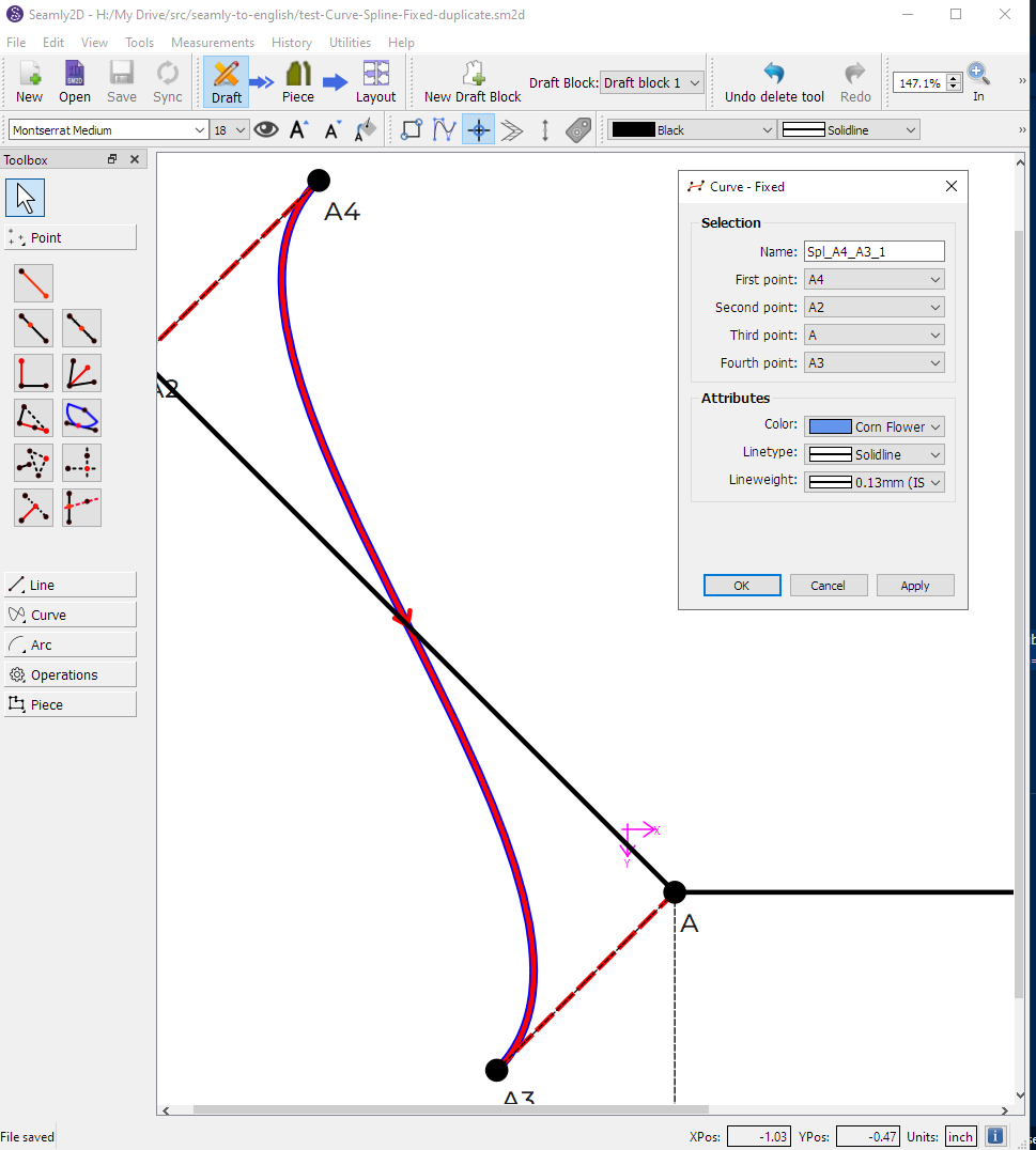

Screenshot of the duplicate’s properties prior to the change:
Duplicate’s XML attributes are duplicate=“1” and color=“cornflowerblue”:
<spline color="blue" id="12" lineWeight="2.11" penStyle="solidLine" point1="5" point2="3" point3="1" point4="4" type="cubicBezier"/>
<spline color="cornflowerblue" duplicate="1" id="13" lineWeight="0.13" penStyle="solidLine" point1="5" point2="3" point3="1" point4="4" type="cubicBezier"/>

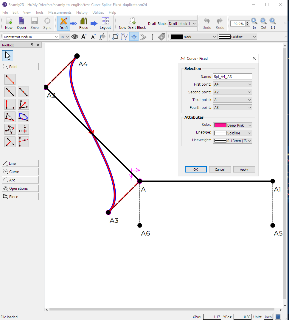

Screenshot of the duplicate’s properties after the change. The name is Spl_A4_A3, same as the original.
Duplicate’s XML attributes are color=“deeppink” and the duplicate attribute is missing.

I know what’s happening. When there’s “duplicates” of a fixed curve (which I don’t know why one would do so) the Name has a count number suffix added. The name is created correctly in the Dialog:
Screenshot 2024-02-10 103210
While the Properties Editor is not creating the name Correctly:
