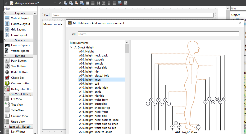

So now I have a question in regards to the ME Database dialog when selected via the measurements->Database menu. Currently it is set as a “non modal” dialog - meaning it opens on it’s own, and does not always have to appear on top of the main SeamlyMe window. The issue is it’s easy to lose the Dialog behind other app windows - as shown in the screencap where I’ve got it on top of the Creator window. I believe I could set a flag to keep it on top of the SeamlyME window. The window also stays open even if you close SeamlyME.
Questions are… does anyone see a need for the dialog to be non modal? If so, should it be kept on top of the SeamlyMe window? Or for that matter is there a need to have Measurements->Database at all… which is simply showing the known measurements that you can just view by using Add Known?
I think we’ve discussed this before, but my take is the only purpose the show database dialog serves is if you wanted to be able to view the database on top of another app - like a text editor or spreadsheet, but even that is limited because you can’t interact with the database and other apps (like cut&paste or drag&drop), and it will lose focus and go to the back as soon as you click off of it.
Thoughts?

Fixed another minor issue with the Me Database dialog window title… “Add known measurement” now only appears when Add New is selected and not when the view only Measurements->Database is selected.

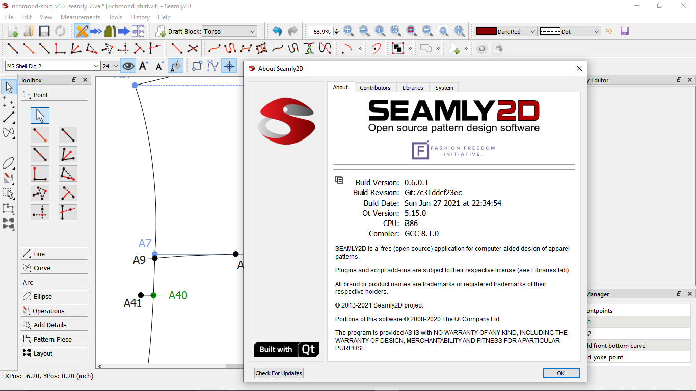

BTW… in the process of updating the dialogs I was finally able to recover most of the work I did on the Help->About dialogs - so the copy to clipboard" of the build info will also be in this build.

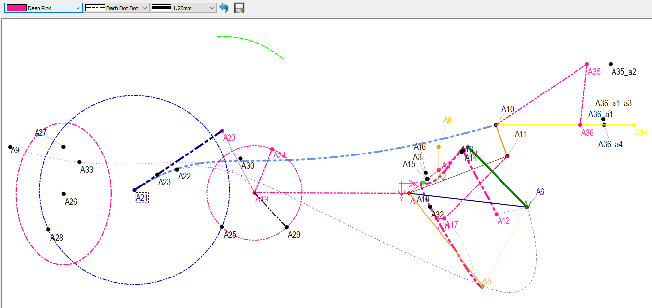

This time around the updates to the Dialogs & Editor include a “current” pen with the addition of line weights. I won’t post all the dialogs… just the ones of most interest - IE the ones that were really wonky before.
So here’s the Pen Toolbar and my ALL tools test mess. :slight_smile: The toolbar is initialized with the (last saved) default settings. So you can change the pen settings, where now every new tool defaults to the current pen - so you don’t have to edit EVERY single new tool. The reset button resets back to last saved Pen, and of course the Save button allows you to save the current Pen as the default (preset). Future additions will include loading presets, so we can have semantically defined preset pens. Yet to be determined is whether that means a set of standard pens, user defined pens, or a combination of both.

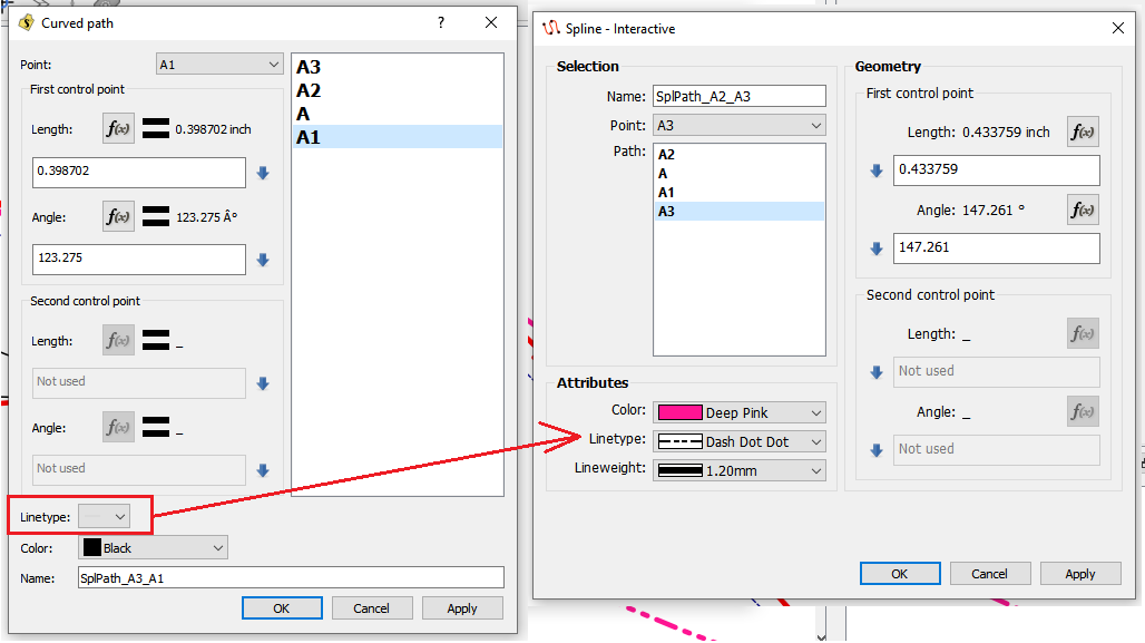

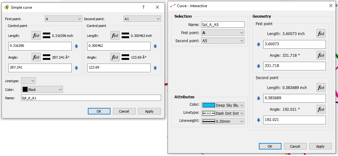

The curves & splines are probably the ones that got reorganized / fixed the most… fixed is the lineType in all of them. Some may note the change in the curve tool name format… there’s now Curve, Spline (which is more or less multiple consecutive curves), and whether the control points are fixed or interactively movable. BTW… I think we need a tooltip to note that in the Spline tools- highlighting a point in the path, and then selecting a (new?) point in the dropdown, changes the point in the path. Currently the path doesn’t immediately update, and it may be confusing to new users.
