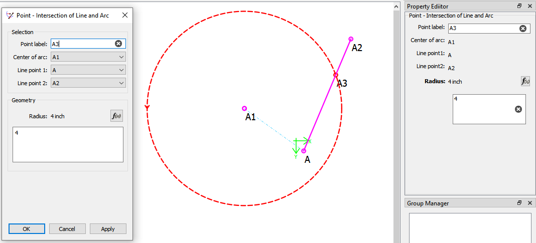

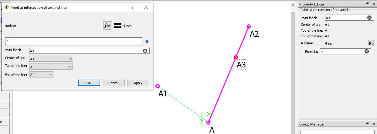

And the last Point tool… sort of. It’s the tool formerly know as “pointOfContact” or Intersection of Line and Arc.
Nothing major here, other than I fixed the display of the Arc.
The sort of… Based on then discussion in another topic I updated the icon for the tool button to more accurately represent the tool operation… where the “black” dots represent selected points and the “red” line represents the arc radius. The red dot is the produced point.
point_intersectlinearc_icon@2x
and I moved the tool where it makes a little more sense… to the Arc tool group.
arctools
I should note that this tool could use some work in the future as there can be a possible two points of intersection, but currently the tool only selects the point closest to the first point of the line.

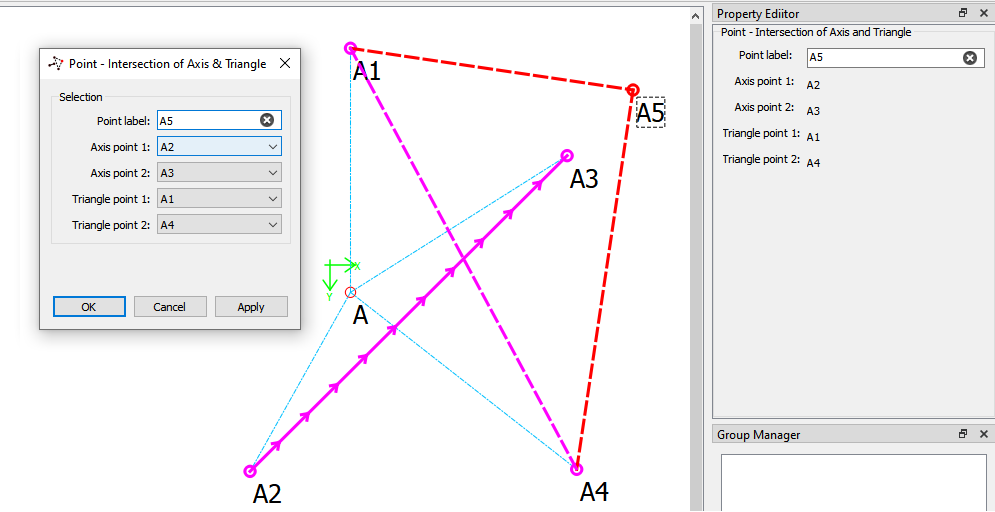

You did the fabulous work, now I have two suggestions :laughing: :thinking:
Could all sides of the Triangle be Red and leave the Axis as Purple? This color choice would visually show the meaning of this tool.
  1. Change Intersection of to Intersect.
    Example: Intersection of Axis and Triangle would change to Intersect Axis and Triangle.
  2. Change Length To Line to Lengthen Line, it’s easier to understand. Yeah I know I made that suggestion… there’s always room to improve. :slight_smile:
  3. Change the Icon for Intersection of Line and Arc (‘’‘Intersect Line and Arc’‘’) so that a green radius goes from green arc center to the red dot on the circle
  4. Update Intersect Line and Arc icon colors to represent the three distinct objects involved: Arc is Blue, Line is Black, radius with it’s intersection as Red bitmap

Updated Intersect Axis and Triangle tool… Just a note - to those that are curious about the display of tools. There are 3 parts to the display of a tool… that which is left on the screen as per the selction, geometry & color & lineType - which is handeled in the tool class.
triangle.val (1.3 KB)
This tool only leaves a point… in this case A5: triangle0
The interactive display as you move the mouse a round selecting points,
triangleinteract
And the visual display when you click on a tool (object) - both of which are handled in the tool’s (point A5) visual class. Here’s the Dialog title change and the visual with the triange all red:
triangle1
And the result if we flip the axis points:
triangle2
It should be noted that I believe this is only tool that the (line) axis shows a direction - indicated by the (many) arrows. Also note that the tool will extend the line as an axis to satisfy the intersection point - as illustrated in the 1st example.
