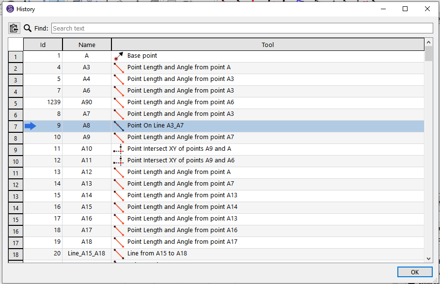

In order to be consistent with the naming conventions for updated Tool Dialogs and Groups, I went ahead and updated the History Dialog as well. The Dialog now displays a vertical header with the row number, and the columns now contains the Tool Id, Name, and Description with tool icon. I also added a Copy to Clipboard toolbutton so you can copy items to the clipboard in CSV format to paste in an editor or spreadsheet. Clicking the header corner selects the whole table.
You may note that now you can easily see that a tool has been inserted into the history, such as ID 1239 at row number 5. Also lines will now be correctly named… such as Line_A15_A18 in row 18. In the future I may update the dialog further to extract more of a tool’s data such as lengths and angles. I also want to figure out a way to reset the current insertion point to point at the last row… as patterns get larger it takes more scrolling to get to the bottom.

That being said, one of the real uses of the History is to be able to go back in the time line and insert a missing point or line. In the attached screencap of one of Grace’s patterns (that I like to test with) shows that point A90 (id 1239) was inserted way back in the timeline. The blue arrow in the pic shows where the next tool will be inserted. So the idea is you can open the History, click on the 1st column on the row where you want the next tool to be added… the arrow is moved to that row. Then you draft your next tool and it’s inserted in the row after the arrow. Just remember to move the arrow back to the end of the History to continue normal drafting. Also be sure to backup BEFORE inserting into the History - it’s not fool proof.
