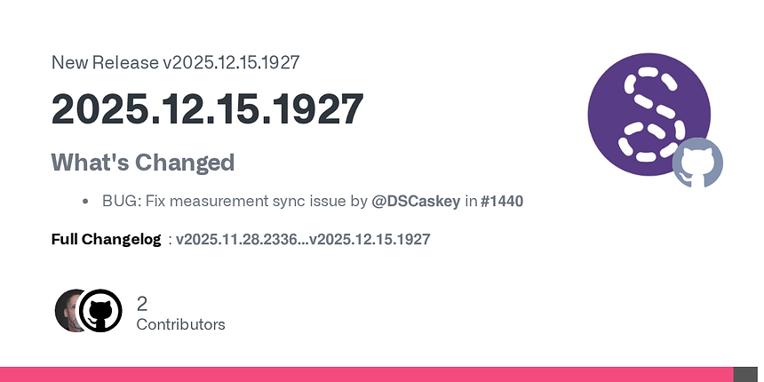

PR has been merged… pre-release avaialible:
