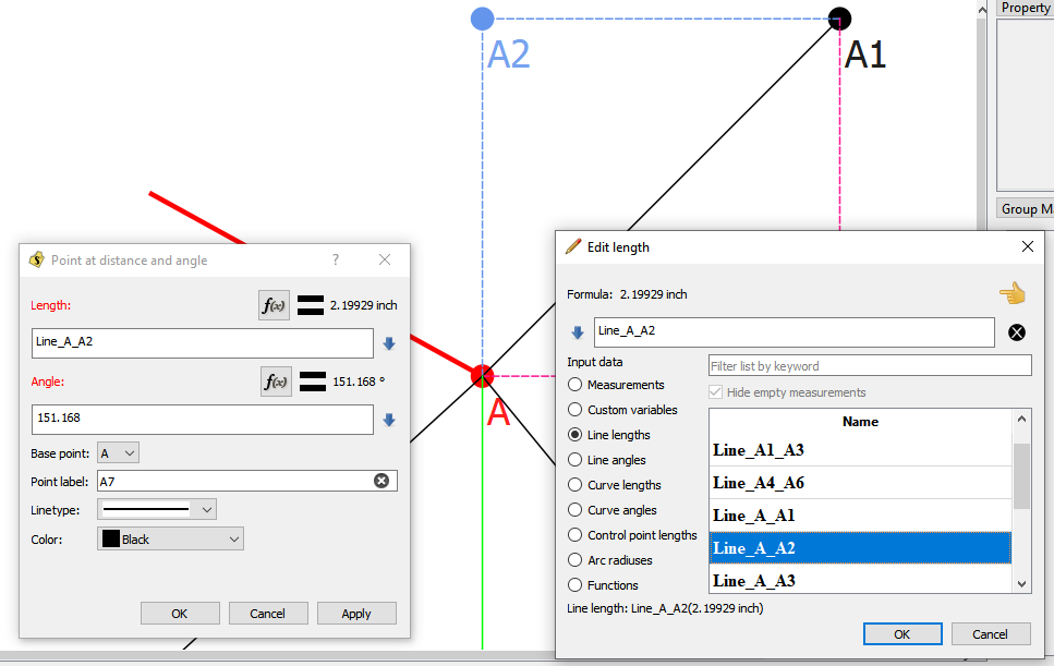

I hope that in the release version those lines are referenced as Line_A_A2 & Line_A1_A2 in the tooltip, instead of Line 1(2) Length
You can always just set the linetype to none OR add the tool to a group and hide the group, albeit that would also hide the point name as well. The real benefit though is not so much the fact that the lines are persistent, but rather you save 2 steps of having to create two lines for the lengths.
Yeah, I noticed that. line1 and line2 are the variable names for the line items. Don’t know why I hard coded the text like that as I specifically added getters to retrieve the actual line names. Doh.

As an aside - Some of the tooltips are formatted stangely - like the Point Along Line… instead of Line_A_A2 it uses A->A2, for ex:
paltooltip
I would prefer to make them consistent with the rest of the tooltips, the Fx, and Variables table.

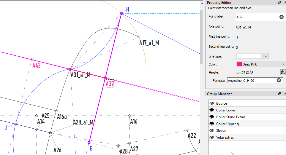

I have this shirt pattern that I’m making and the sleeve cap is drafted according to the armhole, and this is where that Point of Intersection tool comes in so handy in making perfect curves that resize beautifully… but it doesn’t work in this case:
It is still possible to do something with the other, existing, tools. :grinning:
But it can be a thought for the future…
I just call it being efficient. :slight_smile:
Ah. The example definitely helps to visualize. This is certainly doable. It’s just a matter of how to have the interaction work, and whether the intersection angle is variable, or set at 90 deg. Locking the intersection at 90 it’s bit harder to implement the visualization, but eliminates the issue of what to do if the 2 axes do not intersect all.
Actually, there is a tool that does this very easily… Here’s what I did:
I repeated the the same tool to create A42 on the new line A37-A31_a1_M from J at the angle G-H, and only needed a line between A31_a1_M-A42 to complete the scaffolding for the sleeve cap curve.
