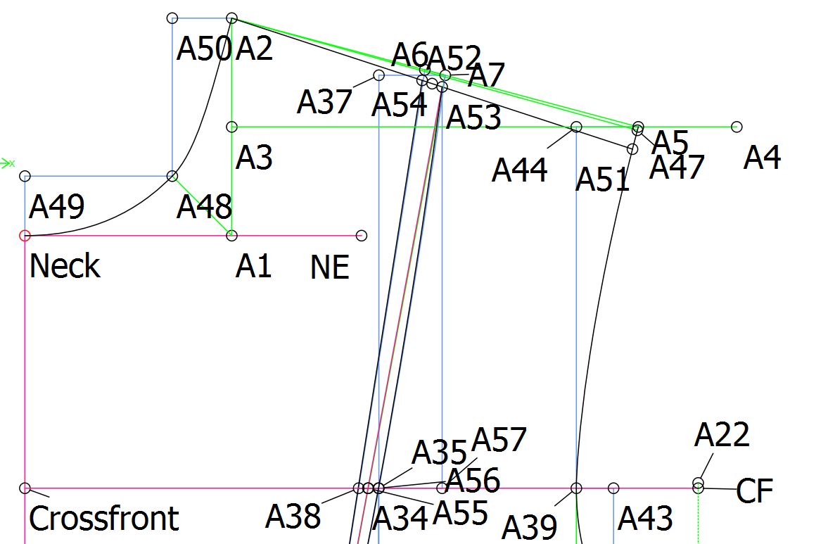

Here is my Front Shoulder. All of these were drafted first. The highest Green shoulder line was my first draft, then Once the armhole is drawn, a second green shoulder line is drawn to the new point on the armhole. This is my first shoulder adjustment.

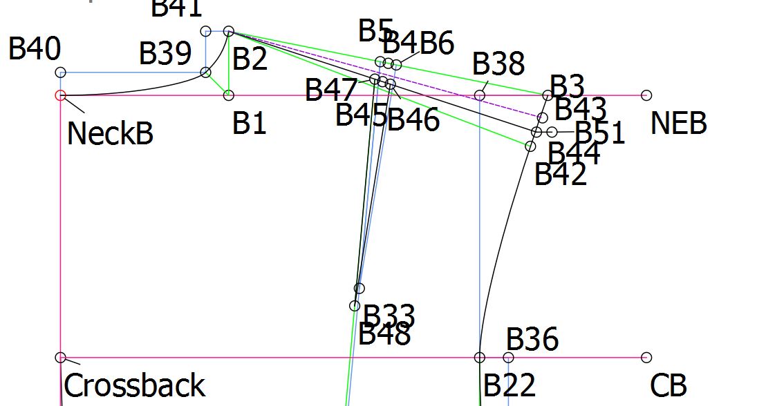

Then here is the Back Shoulder.
The Highest green shoulder line was again drawn first, then after the armhole was created, The lower green line was drawn as the first shoulder adjustment. I am then able to use the information from the front the create the purple dotted line ( it has the same length and angle as the lower green line from the front shoulder)
With the purple dotted line and the lower green line on my back shoulder, I’m supossed to true up my shoulders to make them the same angle and length. I am supossed to do this by taking some of the front shoulder and giving it to the back ie, lowering the front shoulder and raising the back the same amount. So I found the mid point on my arm curve between the lower green line and the purple dotted line. This I made my final back shoulder, and redrew the final shoulder in black. I then adjusted my darts to come from this line instead.
