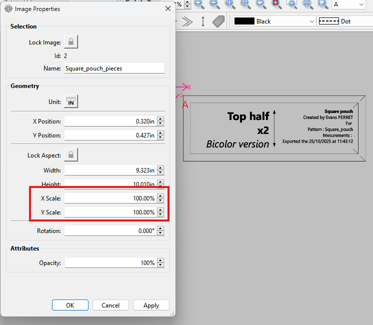

When I add an Image file (SVG) to a pattern the image is shrunk. Is there an easy way to resize it to full size?
Hmmmm… it should be importing at 100%.
Open up the properties - use the Context menu:
And check if the x /y scale fields are 100%. If not you can set these to 100%. If you lock the aspect ratio you only need to change one of them.
You can also switch tp pixels andf check the width & height of the svg to see if it’s correct.
Also you can set the width & height to match what the svg should be.
Thanks, Yes it says it is at 100%, but I have to increase it to about 135% for it to scale correctly.
