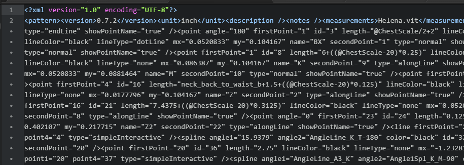

    1. Minor - The output file is not being written as proper XML… opening and saving in Seamly will format file correctly.

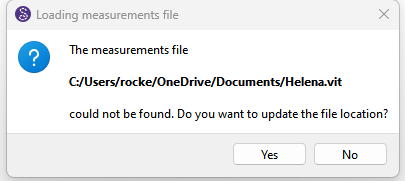

    1. Even though the pattern file had an attached measurement file, the conversion is requesting the hard coded Helena.vit from the script.

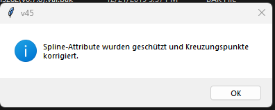

    1. Also can’t read German:
      But upon translating not quite sure what the info means: “Spline attributes have been protected, and intersection points corrected.”

This was because I had the issue that Seamly did not ask for the pattern file sometimes and then all formulas were not recognized. We then implemented a measurement file name no one has to force Seamly to ask for the file, but Gemini renamed that while we were working on a pattern for a dress I made for my daughter Helena :wink:

What difference would there be if you actually used the measurement file name in the pattern vs a made up file name? Of course if the pattern doesn’t use a measurement file Seamly is not going to ask if you want to use another file if it can’t find it. The point is the message box is should supply the name of the file it’s looking for, not some made up file name.
It’s not a last error. Its a hardcoded info message box that always shows that text
messagebox.showinfo("v45", "Spline-Attribute wurden geschĂĽtzt und Kreuzungspunkte korrigiert.")
And again… I’m still not sure what it means?

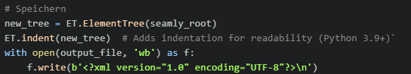

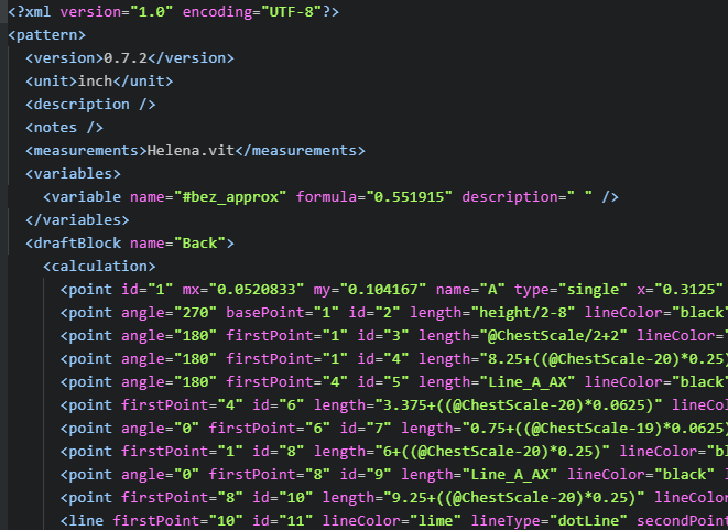

BTW adding
 ET.indent(new_tree)  # Adds indentation for readability (Python 3.9+)
here will fix the xml output.
Thanks Douglas, I was unclear on this. In every of the 45 versions, gemini fixed an import error and hardcoded the last one in the script. So this was the last error fixed from version 44 to version 45 :slight_smile:
You can completely disregard this, in a final version, nothing like that should show up.

It could be used, would imho be the best solution, if the absence of a measurement file is detected and then a made up file is inserted to work around that error. Good point! Will try to get Gemini to implement it.

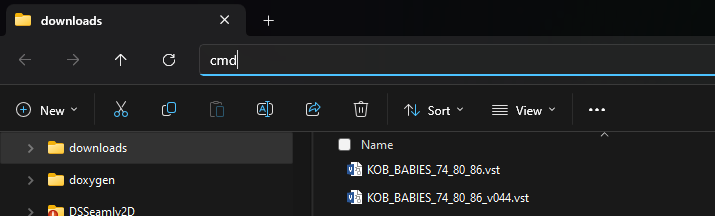

An easy way to open a command line in Windows is to type “cmd” in the file path:
It will open a command line in the selected directory (where the py script is located) where you can type python Konverter.py…
