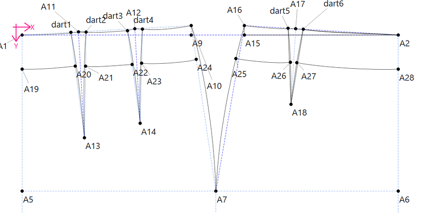

hello, I would like to draw a waistband from a skirt that I drafted.
I know how to do it with pen and paper, but it doesn’t seem to work this way in Seamly2d
I marked points from the waist (4,5 cm) down, to create pieces that I later wanted to merge in ‘Pieces’. But Seamly 2d crashes when I do that.
What’s the best way to make a waistband with the measurements of the skirt? I want to create a multi size pattern

In the ‘Draft’ mode you will need to use the Rotate tool from the Operations toolbox.
- Select the objects you want to rotate. Using your example, & I’m making assumptions about your spline names, I think you’d choose
dart6, Spl_dart6_A2, A2, A28, & Spl_A28_A27
- Hit Enter
- Select
A18 as your rotation point.
- Enter
AngleLine_A18_dart5-AngleLine_A18_dart6 (or whatever formula actually matches your pattern) as your rotation formula.
- Click OK
If you didn’t change the suffix, you will now have point dart6_a1 overlapping dart5, A27_a1 on A26, & curves, A2_a1 & A28_a1 sticking out up from the draft.
Each new instance of the Rotate tool will add another layer of suffix. So, for instance, if you started on the left side & closed dart A13, & then dart A14, you’ll have a point A1_a1_a2 curved out away from your main draft with its friends.
I hope that helps! If my guesses are completely off & you aren’t seeing how to make them right, please feel free to post your pattern & measurement files, & one of us will help you get it working right!
Happy drafting!

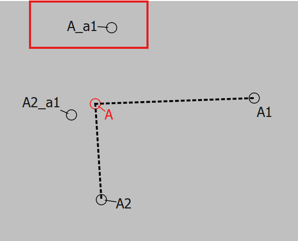

It’s the ‘_a1’ appended to the Point name. For example I rotated point A… so the new rotated point’s name is A + the suffix ‘_a1’.
Rotating point A_a1 creates point A_a1_a2:

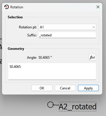

You can change the suffix to what ever you want:
The default suffixes will be _a1, _a2, _a3… _b1, _b2… etc.
If I rotate point A again it now uses _a3:

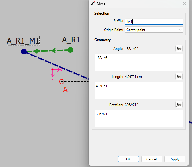

You can also set the default suffix for each Op tool in the prefs. For example I set Rotate to use _R and Move to use _M
Now when you look at the point names you know what type of tool was used. Here I rotated point A, then moved point A_R1 to create point A_R1_M1.
If I had used the default a1, a2… the rotated & moved Point would be named A_a1_a2 not knowing what tools were used or in which order… without looking them up in the history.
