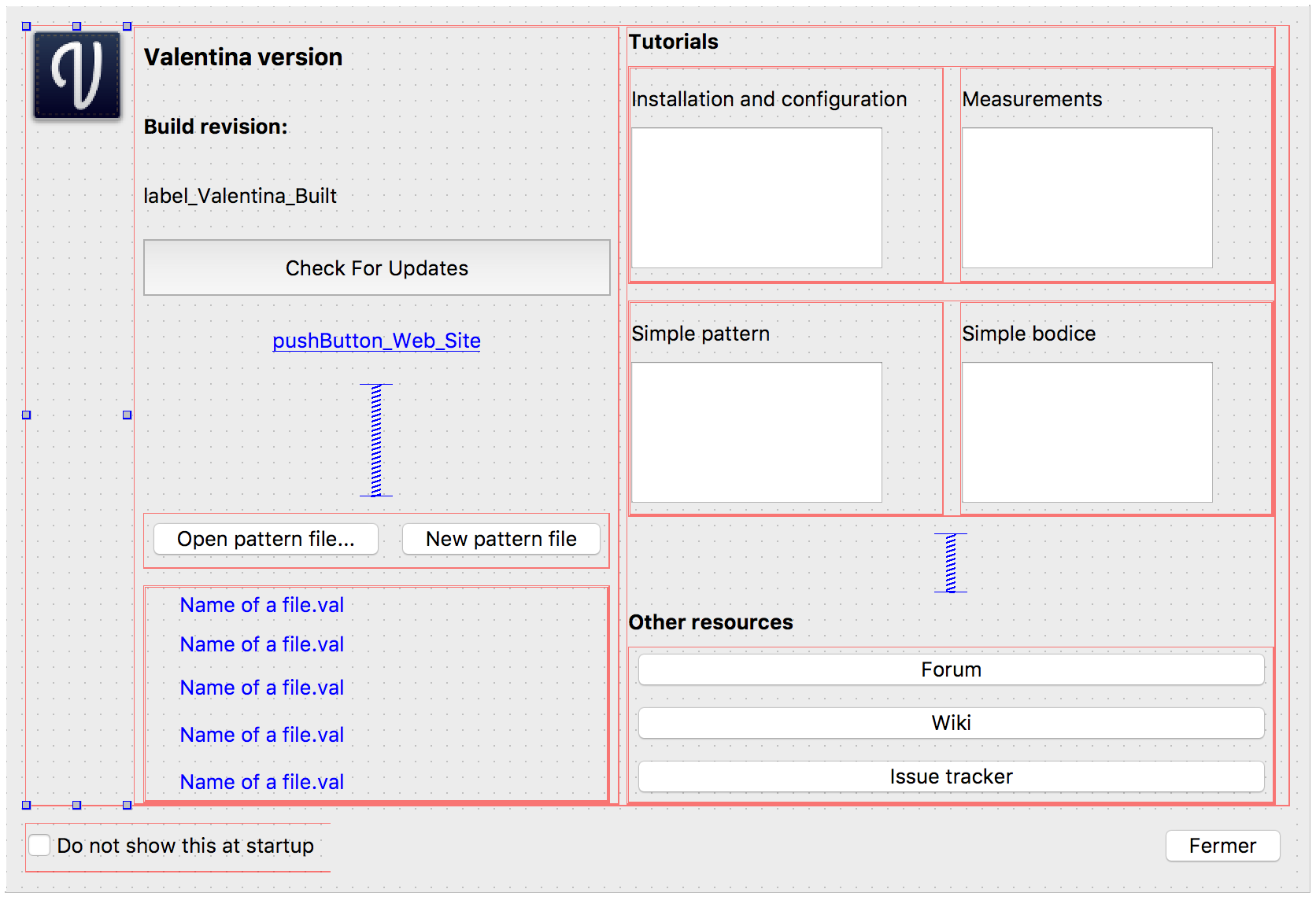

Hello, I started working on a welcome screen proposal. The idea is quite classical nowadays, it is a screen that shows at start time, and provides users with some key features that are very often used (file creation, load a file among the most recently used…), and to key information resources (tutorials, forum…).
Here is a picture of current status of the UI. It is a view from the developer editor, so it is not exactly what would be displayed (build revision would be written, white frames would be pictures of the tutorial…).
What do you think?

I’m not familiar with programming but just designing models. In my opinion, having a more orderly and intuitive start page in the choice facilitates navigation. In my opinion and a great idea. If I learn to use the program well then I can contribute to the growth of the forum. At this time I find it difficult to find the help or information I need. However thanks for the program and the nice job you are doing. Excuse my English but write with the translator Laura from Rome

Opening page - great idea. Especially for a newbie, but also for experienced users.
Information on the available sources, forum, bitbucket etc. and what each is for would be great.

I really like the idea of a welcome screen. The concept @yannlossouarn suggested looks like a good concept.

Agreed Good idea… but I would fix some existing issues before adding anything new. In any case just a couple thoughts:
  • Probably obvious, but replace Fermer with Cancel
  • Not sure if “issue tracker” is appropriate for new users for whom a Welcome screen is geared towards
  • Make sure there is content to fill the tutorials
  • Maybe add a button to launch Tape
  • In addition add the pattern ver which is different than the program revision.
