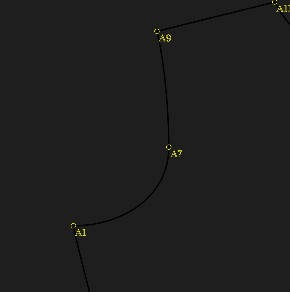

Just another quick question… my Aldrich pattern drafting book generally recommends to draw the inflection point of the armscye smack dab in the middle of the start of the armscye and the end (on the y-axis that is, they differ of course on the x-axis). Yet I have seen some design where this inflection point (where the curve changes angle/the deepest point of the curve) isn’t exactly in the middle but rather a little lower. What are the stylistic choices that could be behind changing the height of this point?

I’m not quite clear on what you mean by inflection point… perhaps a picfture could help?
That being said… differences in a draft may have more to do with size, fit or body type, rather than style.
Yes, Aldrich places the armpit point halfway between the across back & across front lines. Some systems place it at 1/3 of the way while others say move it backwards by 1cm. Others don’t even draft the armscye front and backs in the middle of the bodice pattern. Who is correct? I really don’t know, but having the armpit point in the middle, you can have the sleeve center line in the middle, too.

I would refer to A7 as an inflection point.
Rather than the exact location of the point, the imaginary vertical line passing through the point is more useful to me as it indicates where the edge of the curve should touch. (Bunka chest width line, M&S front pitch line, Myoungok interscye line, Jungclaus front armhole line). They, even Aldrich put the “inflection point” on this line.
I often raise or lower the position of the point to get better armhole shape, just according to my feeling. Sometimes I just use one bezier curve connecting the shoulder tip and armhole, which may not touch the point, but not far off.
As @najdmie points out, and as I previously speculated - point A7 is fit related rather than style. With the exception that A7 may also be a point where you could start a princess style seam line. Point A7 is there to establish the front width armscye to armscye… the armhole does not have to pass through this point, but you generally do not want the armhole to go past the vertical going through A7. As a rule of thumb though I would say that point A7 should be located 1/2 the arhmhole depth above the horizontal A1 to An.
And I would agree here too. If you need to resize the pattern, it’s going to be easier to get a smoother armhole by using one curve from A1 to A9, and not using A7.
