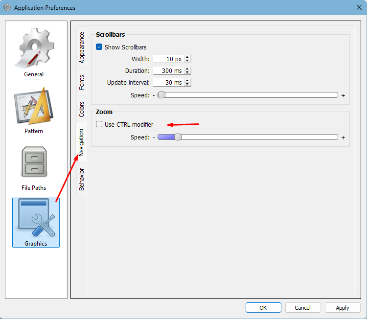

I find the zoom feature to be lacking a bit. In Autocad, Blender, Illustrator, etc. I can always zoom in and out quite easily either using a shortcut key and/or my mouse.
I seem to always have to use the buttons up at the top right corner. Even ctrl + which is supposed to zoom in only zooms to the point of fit and then it doesn’t work anymore.

Go to File > Application Preferences and go to the Graphics on the left & the Navigation folder. If you want to use the CTRL key with the wheel to zoom, then place a check mark here - I prefer just to use the wheel to zoom without the CTRL key - I set the speed to 10 because otherwise it zooms to fast for me:

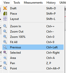

The View Menu:
One of the key shortcuts.

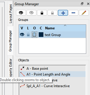

Double clicking on a group object in the Group Manager:

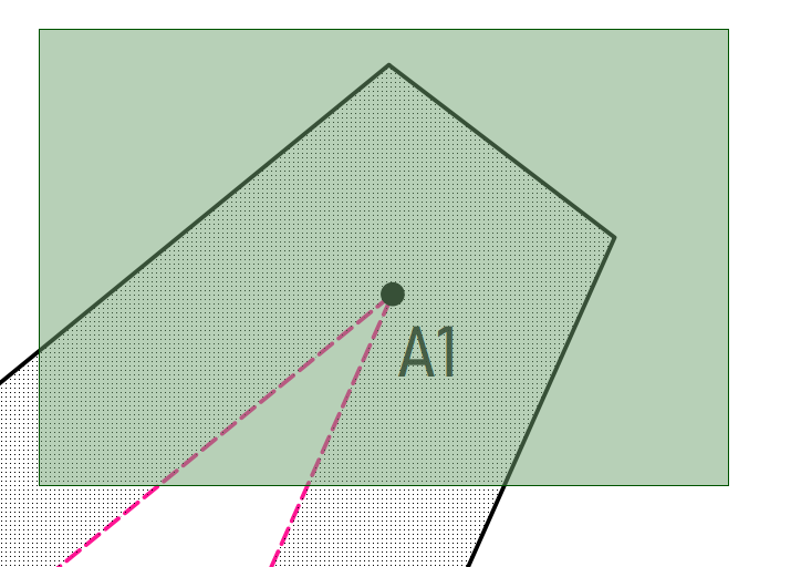

Another Zoom related feature is when using the Zoom to Selected area:

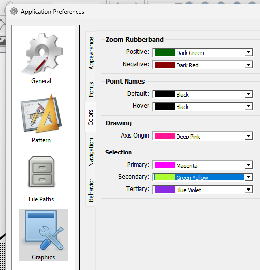

You can select the rubberband color for whether you’re selecting in a postive direction or negative direction:
Positive - Down and to the Right:
Negative - Up and to the Left:
Thank you so much!! Actually I had read somewhere to use the scrollbar and it didn’t work for me so I figured they deleted the option in a new update or something/
Turns out in my default setting the CTRL option was checked so that’s all I had to do to get it to zoom. Thanks again!

Yes… the Ctrl option toggles the bahavior of the zoom and vetical scroll. I found having to hold the Ctrl to zoom was annoying as I’m use to just using the wheel to zoom in CorelDraw. To me scrolling with just the wheel only makes sense in a text based document. So I added the option to switch the behavior. :slight_smile:
