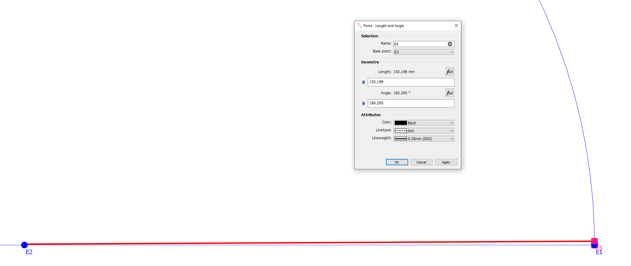

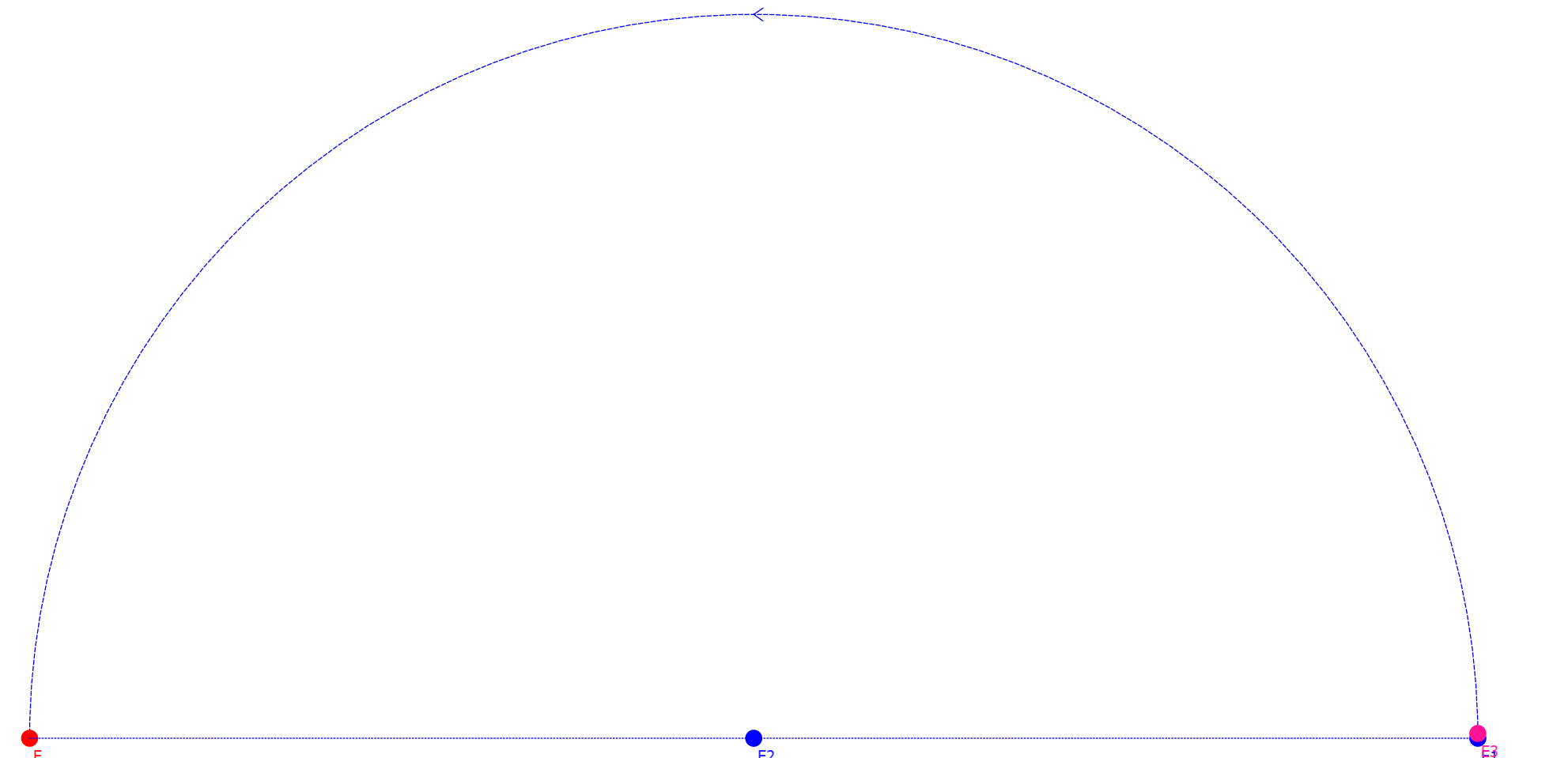

Draw a horizontal baseline of 300mm (arbitrary!) and angle:= 0° Set Point-on-Line := CurrentLength / 2 Draw an arc, Radius-and-Angle in the midpoint just set Params : Radius=150, 1st Angle=0°, 2nd. Angle = 180° (no particular significance here … arbitrary value!)
Now set a Point on Angle with Angle = 0°, Length=0mm.
My results are:
20250121123300_point.on.arc
This Point-on-Arc is clearly not at Angle=0° (as reported in the properties dialogue) and the point is off by 1mm.
Is this an acceptable variation, or should I / you be concerned - I am generally a stickler for accuracy and therefore making this post.
The point on Arc tool has to have a greater than 0 length so a minimum length of 1mm is the default. Besides , a Point on Arc with a 0 length would be pointless as the point already exists.
