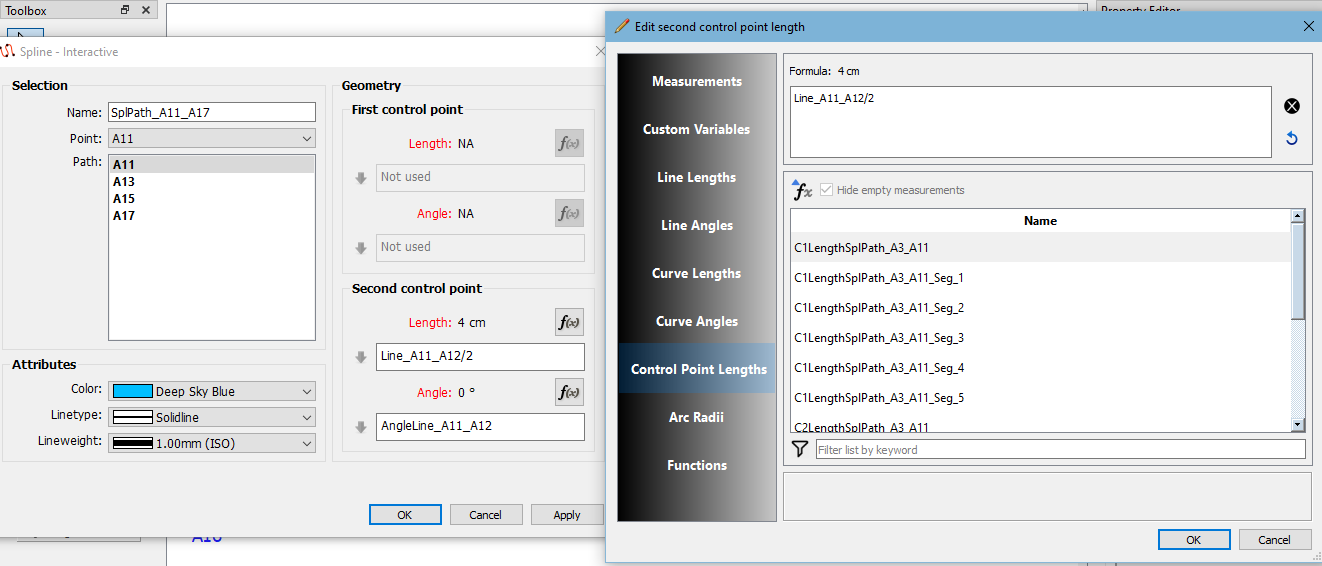

In the properties dialogue for a spline
The ‘Length’ and ‘Angle’ of the control points seem to be dynamically settable by ‘Functions’ involving external values. I wanted to be to copy the properties of a point, which I wanted to ‘mirror’ (Not the Mirror-Tool!) I saw to my dismay that although ‘Control-Point Length’ was apparently foreseen to be evaluated, the table is not filled - on that subject, there is currently no provision for ‘Control-Point Angle’ … Are there plans to realize this functionality? … I hesitate to ask Douglas, but find (for lack of other inspiration) that being able to use these properties would be very useful.
The only other method that I have seen (in a beginners class by @Grace ) was to connect the points on the curve with Point_Line&Angle and then use these lines’ properties as the reference for the control-point functions. I assume that currently, this is the preferred method.
As one can plainly see, I am still struggling to find my bearings in this application. There seem to by a multitude of ways to achieve a particular result. My problem here is, that the paths I have taken, to reach a result have nearly all ended at a dead-end because of inherent problems which I have built into my structures, and this seems to be down to my inability to use the tools provided to their maximum potential.
Hello, @DavidDeb
Remember that XML is very linear. If you haven’t created a spline/curve before this one, then there’s nothing to show in the list. It won’t add something that you used in this spline because it hasn’t been created yet.
If you look at one of the files that I sent you the other day, you’ll see that I created separate splines for each section. If you open the formula wizard on one of the splines, you’ll see that the ones that went before are listed.
