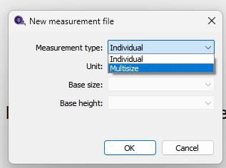

Question 2) For multi sizes?
I’m trying to make the process of creating a pattern and grading a lot faster and efficient.

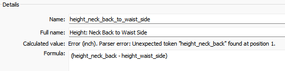

Understood… but there’s good reason why we ā€œidiot proofā€ software. Plus with SeamlyMe is goes beyond just checking if known names and values are correct… measurements often have to be in the correct order due to formulas… such as:

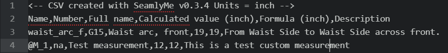

I’m adding CSV Import to SeamlyMe. :slight_smile:
First I cleaned up the CSV Export by refactoring & removing an uneccessary 3rd party lib RT used to model the CSV. Yay! More bloated code gone.
I also added a creation line to the header and added the Description field which was missing from the current Export:
