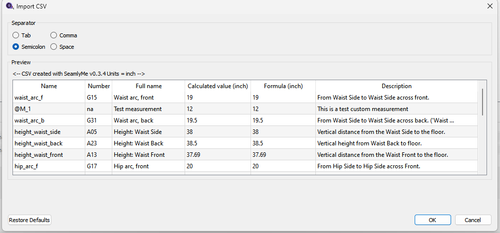

Arrrggg… ran into a semi speed bump. Since some of the 'full name" fields of known measurements contain ‘commas’, we can’t use the commas a seperator:
So we’ll have to use the semi colon as the seperator OR we’d have to change all the known measurement full names and descriptions that contain commas.

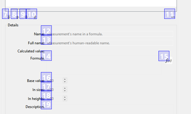

The TAB order is something that is defined for a form in Creator. Here you can see part of that TAB order for SeamlyMe:
Now that I’m looking at the TAB order, I would change the order, or change the focus of the FX button to No Focus so that in an Individual measurement it would skip from Formula to Description when TAB’ing.

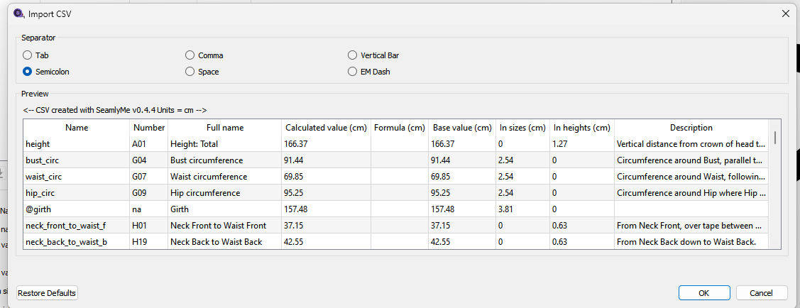

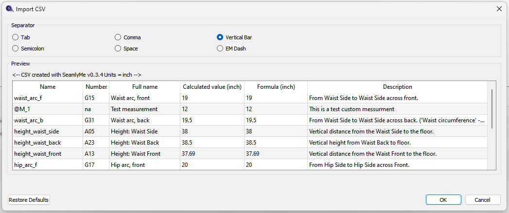

That being said… We now have a working CSV Import. At least in English. :blush:
I also added the Vertical Bar and the EM Dash as separator options.
Oh, wow! you’re my most favourite hero!!! :star_struck: Does it work for both individual & multisize?
No probs, I prefer the import function :grin:
Yes.
You create a new individual or multisize file… then import your CSV, which then populates the form. Currently I have it checking if the “Name” is a valid known measurement or begins with ‘@’, and is not empty. I need to add some additional checks, like is the CSV for an individual or multisize, as well as dealing with a CSV that contains translated Names, and if the CSV contains the “”<-- CSV created with SeamlyMe…" on the 1st line and the table header names on the 2nd. A bonus would be to have it auto-detect the type of seperator. and map the columns in the proper order if for some reason a user switched them around - which would also require checking if each header name is correct.

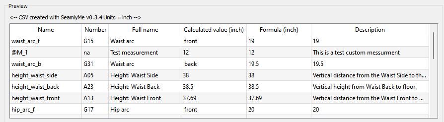

Check some more off the list:
Export CSV now writes a header line including the type, ver, and unit:
Screenshot 2025-05-19 141139

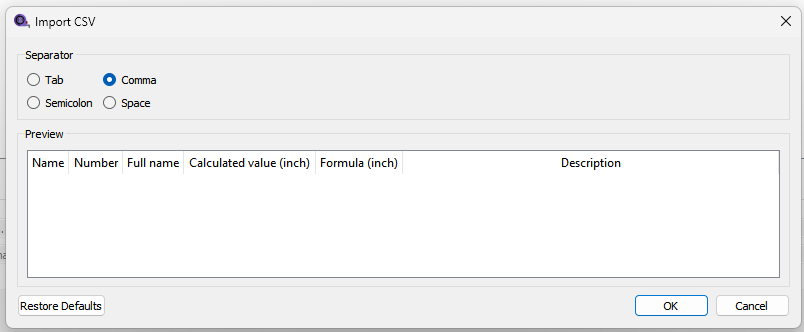

Import CSV will now check if this header exists and if the Table headers exist (does it contain col 1 “Name”).
If the CSV header does not exist it just shows:
If no table headers are found it’s not a valid CSV:

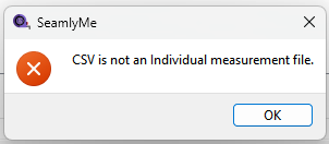

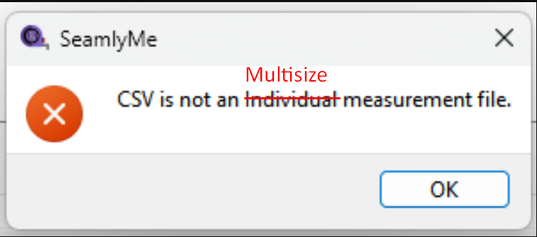

It checks for measurement type - basically does column count match: If you try to import a multisize into an individual"
And vice versa:
Or if you simply try to load any random CSV file. Could add a check to make sure every table header name exists in the CSV, but it might be overkill?

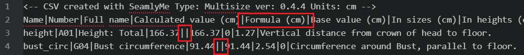

Note: Even though the “Formula” column is hidden and not used in Multisize measurements, it’s still part of the Table widget and gets exported and imported to and from an CSV. It needs to remain or it breaks the column count Whatever data is in that column’s cells is ignored.

Oops… grabbed the wrong pic. The exception does say Multisize.
