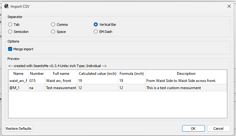

Also to note… while testing I came across another thing to add. The way the import was working was to just add the imported measurements to the existing loaded / imported measurements. I thought maybe maybe a user might want to overwrite the existing - adding only the imported measurements. So I added a “Merge import” option.
Checking the Merge import option merges the import with any existing (like importing from a pattern), while unchecked, the import will overwrite any existing.

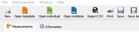

I also added and Import CSV toolbutton & icon to the Toolbar:

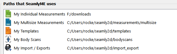

I added a path pref for Import / Export"

Made some additions to the Import CSV.
  1. It now checks that all the table header names are included in the csv file… regardless of column order. If any of the header names are not found the import is terminated.
  2. It now maps the column data to the correct column if for some reason the columns get switched around in another app such as Excel.
