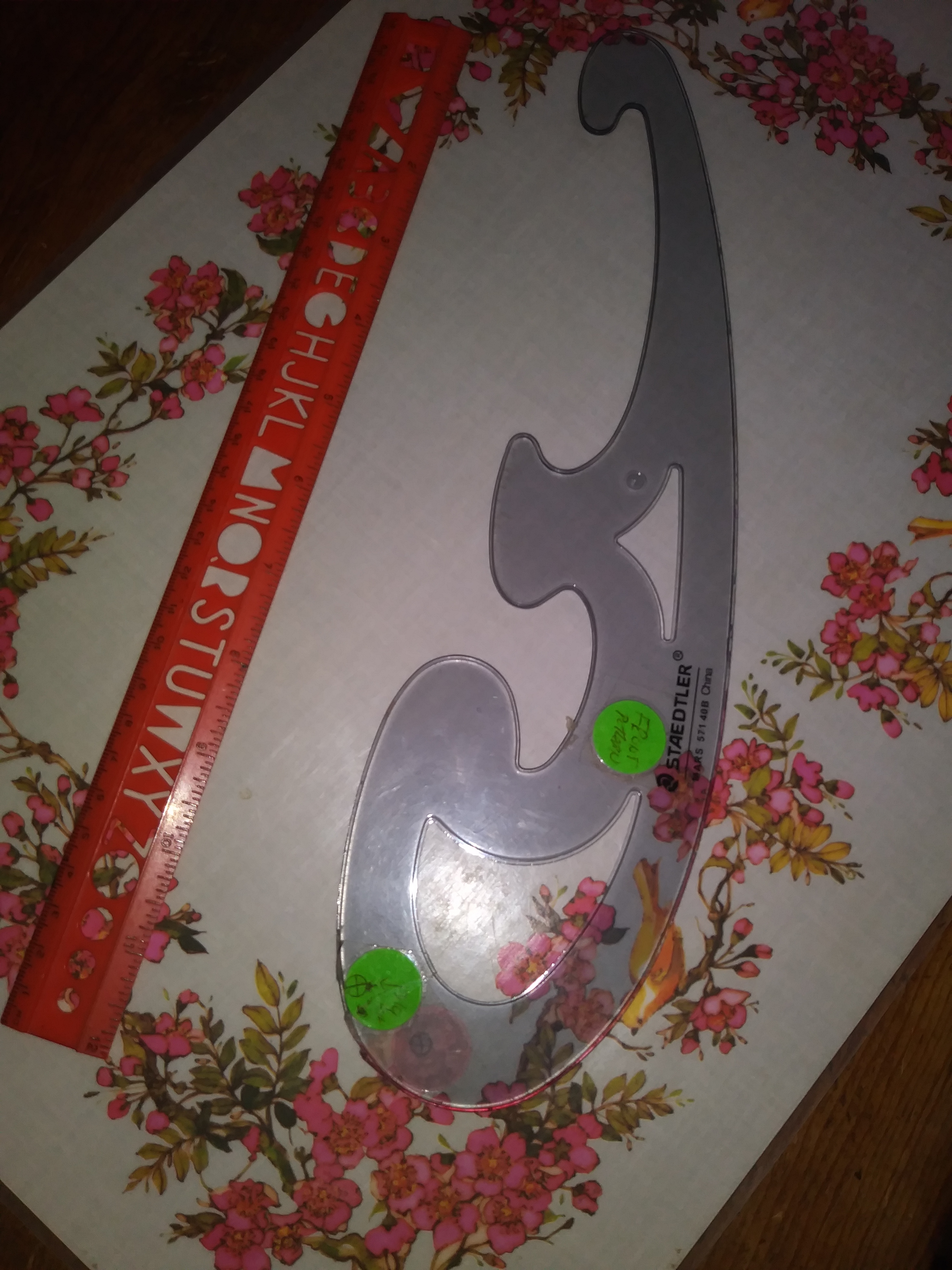

Here is a picture of the curve tool that I use when I adapt patterns to fit actors at our local theater. Crude, but effective

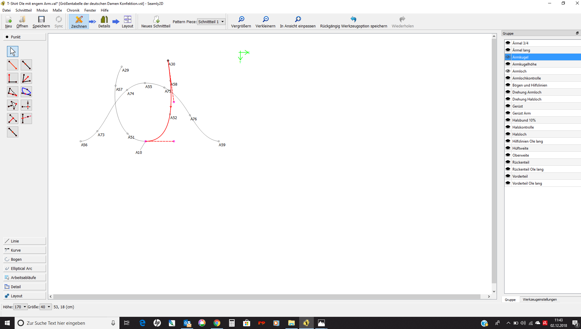

This will allow the tool to replicate the behavior shown in this image from @Scholli :
https://seamly.discoursehosting.net/uploads/db1488/original/2X/a/a6aed6e8813648fbf517bc26c7d8f06d9cd74cff.png
