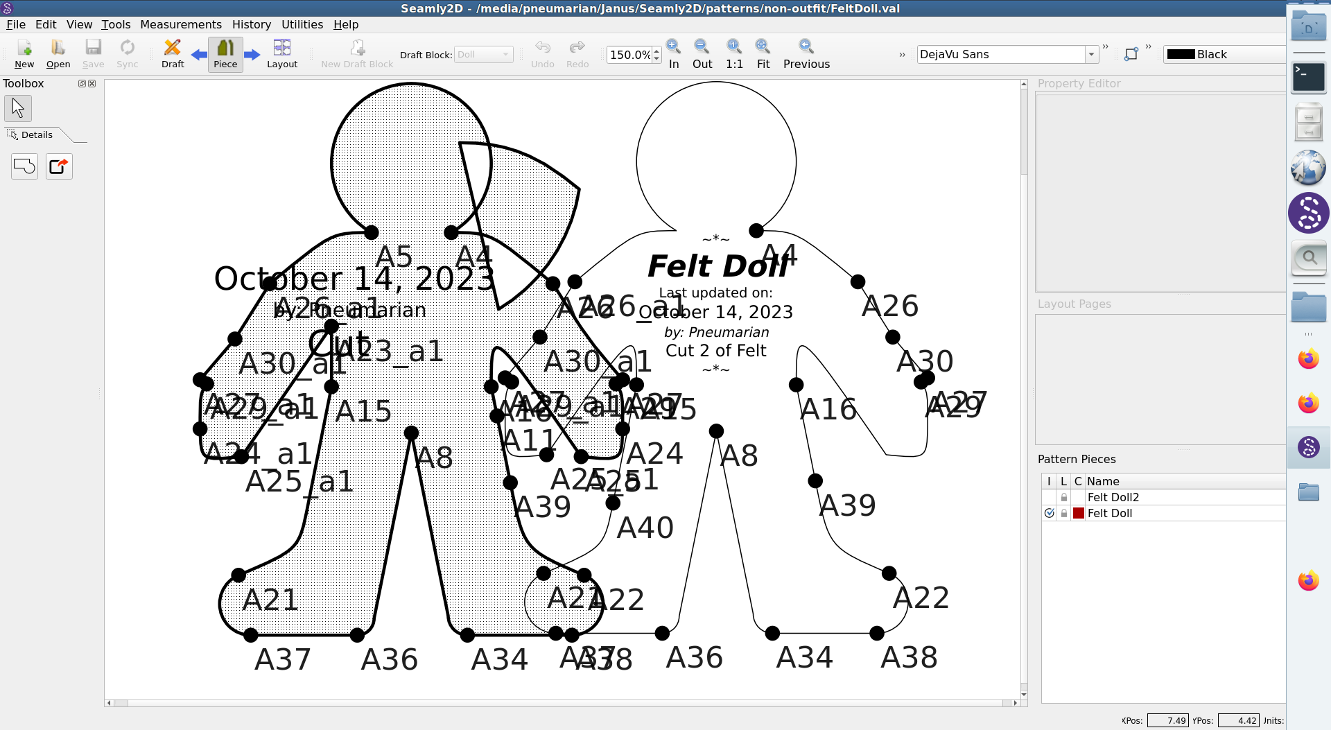

The Issue: Something relating to the seam allowance is breaking my pattern. My doll has a chip of Reuleaux triangle on her shoulder. If I attempt to export from Piece mode, all that exports is the label. Layout is just weird, the only way to get the pattern piece to print is to check that the seam allowance is built in —which is fine, since it is— but the label refuses to have anything to do with it. Assuming that re-drafting it doesn’t avoid the bug, (I think there’s a good chance something went wrong in the XML, but the result is just so weird,) until this is rectified I’ll just use InkScape to clean it up, which I’ll probably need to do anyway to prettify it.
Stats: Linux. Ubuntu 20 & Devuan chimaera. Built & AppImage from 2023.10.09, as well as several AppImages back to April. Here’s the file: FeltDoll.val (28.8 KB) & here’s a screenshot:

More like where the Main path is starting. I rotated the starting point to A6_a1 and you can see the difference. It’s probably related to that “fuzzy math” thing, where when creating the seam allowance it can’t find an edge and strange things happen. The sharp acute angles at the neck are probably at the cause of the issue. Also there’s a glitch like @Grace mentioned… probably due to the use of a fixed curve with the 2nd and 3rd point as A30 which is missing in the path. Why the use of a fixed curve instead of an interactive spline from A26 to A30 to A27? Actually if you had a point at the ceter top of the head… the whole half of the pattern could have been one long interactive spline. The you could just mirror the curve. :slight_smile:
