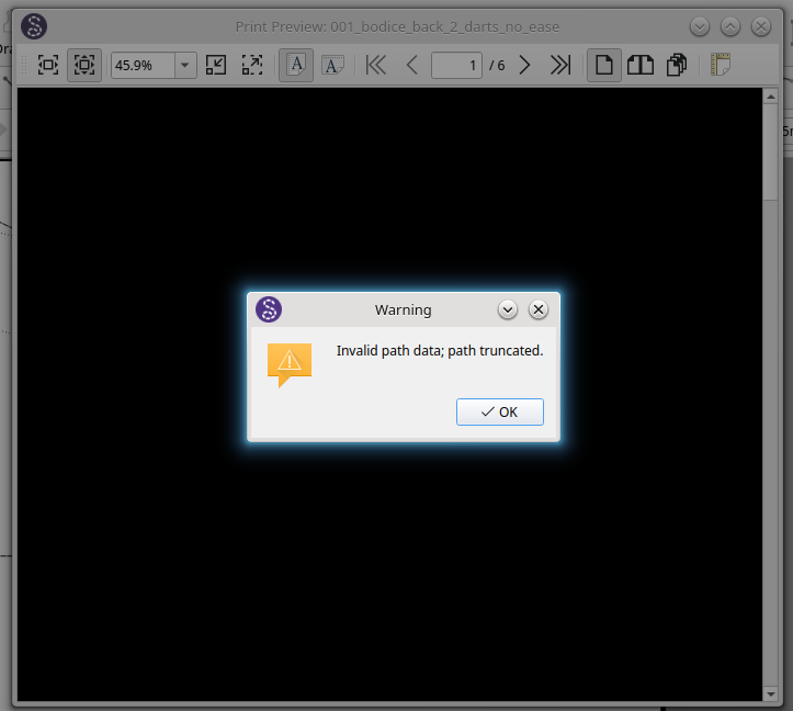

Print preview error: Invalid path data; path truncated
In layout mode, File > Preview > Preview tiled PDF The error message that comes up is: Invalid path data; path truncated

The error occurs with when I go to print preview all patterns.

That said… can I get a clarification on the error message… did it actually say
ā€œqt.svg: Invalid path data; path truncatedā€
From my research if this is the case it appears some Linux distros have issues with rendering some SVG’s. Until I can look into it more I suggest trying to change the Theme and see if that fixes the issue.

  1. No, the PrintDialog does not show up at all, just the black window error message, which shows up twice. i.e. I click OK. It shows up again. I click OK and Seamly closes down.

It’s probably(?) not related, since it looks normal today, but yesterday when I was looking into it the print icon in the tiled preview did look a bit odd, almost like it was blank, but with a thick black outline. However, it kinda did look like an old laser printer. I did not think to check the non-tiled preview.

qt.qpa.plugin: Could not find the Qt platform plugin ā€œwaylandā€ in ā€œā€ WARNING:Can’t begin to listen for incoming connections on name ā€˜SeamlyMe’ QWidget::repaint: Recursive repaint detected
Invalid path data; path truncated. QBackingStore::endPaint() called with active painter; did you forget to destroy it or call QPainter::end() on it? WARNING:Couldn’t load ssl library WARNING:Couldn’t resolve ssl symbols
