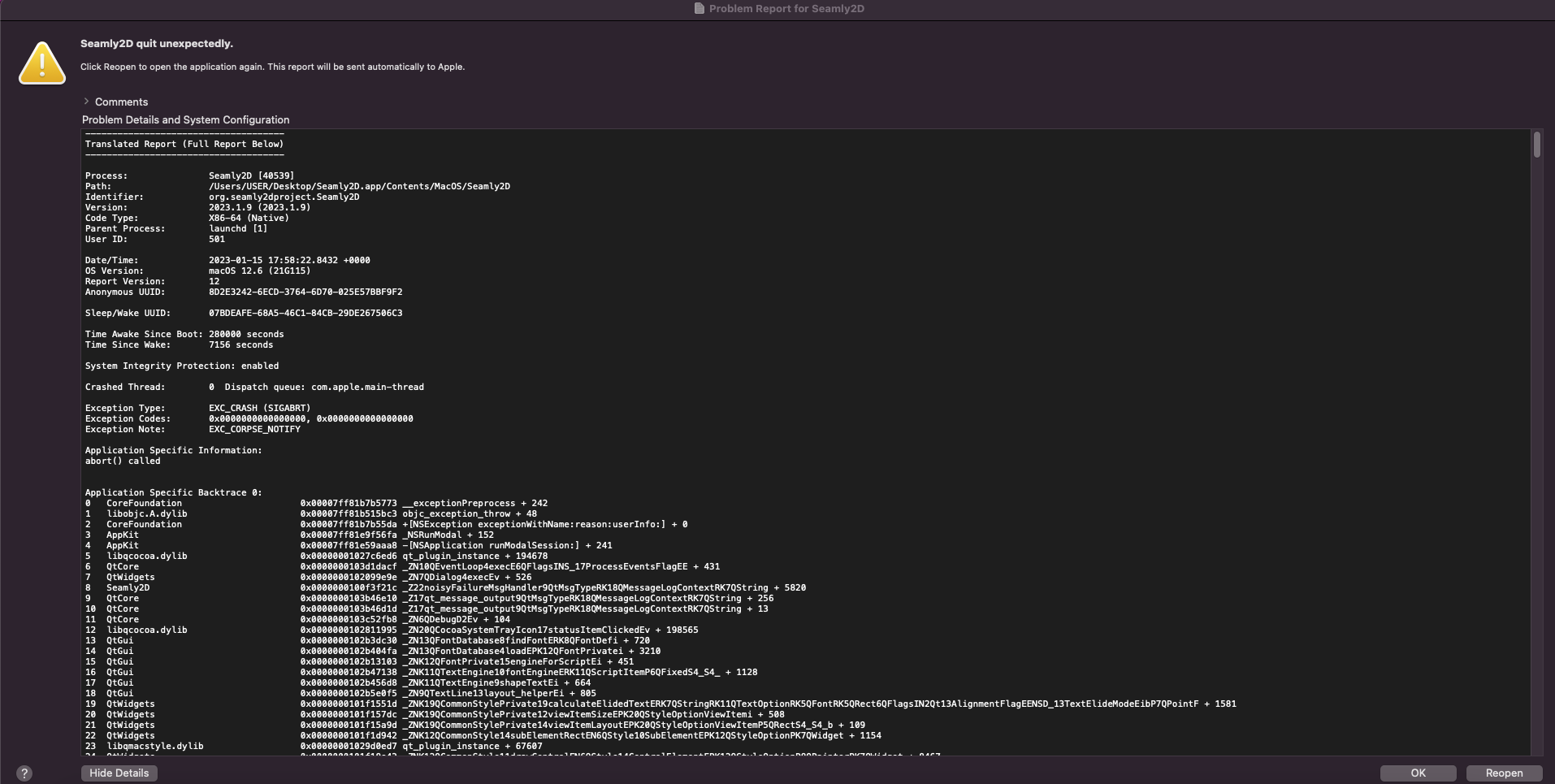

Hoping someone can help me… So I’m new to seemly and just got through adding my first set of measurements into seamlyme. Ive now opened Seamly2d to create a trouser pattern, opened and ‘load individual’ measurements on seamly2d but when I click the formal button to input the formula Seamly2D completely closes.
Help!
here’s the error message that pops up

Perhaps there is helpful information in one of these previous topics on the subject: Seamly 2D crashes when adding formula for measurements (Mac OS Monterey), Formula assistant crashes program, Formula button error crash.
I believe @csett86 is the closest we have to a MacOS dev at present, though @Douglas or @Sue are the leads, so their word is more meaningful.
Also sorry to hear, but I have good news: All the crashes should now be resolved, and todays prerelease contains the fixes: Release 2023.1.15.106-prerelease · FashionFreedom/Seamly2D · GitHub
Please try that or wait for the weekly release in a few hours and try that
The weekly release is now out that should fix your issue among others: Release 2023.1.16.230 · FashionFreedom/Seamly2D · GitHub
