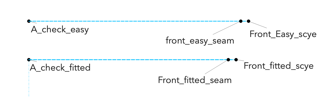

The “dashboard”
Let’s say I need to compare length of armscye holes and sleeve and I have two (fitted and easy fit) version drafted for every thing, using groups to make thing visible.
I can draw a little widget like the one @Douglas used here:
and compare the seam length of armscye hole and armscye length on the sleeve. I would have two lines: one for fitted and another for easy fit version. something like a “dashboard” as this one:
I can only draw it in the sleeve because otherwise I cannot reference points in the future. Am I correct?
But what if I afterwards add another block and want to check some part of it, in the same place? I will need to rebuild all the “dashboard” in the newest block or accept to split the “dashboard”, Am I correct?
