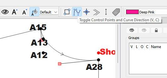

Older versions of the app had a problem with repainting the control paints recusively which would eat up much ofthe CPU usage. That shoudl be fixed in recentversions, but you could try toggling the view of the control points off ans see if that makes a difference:

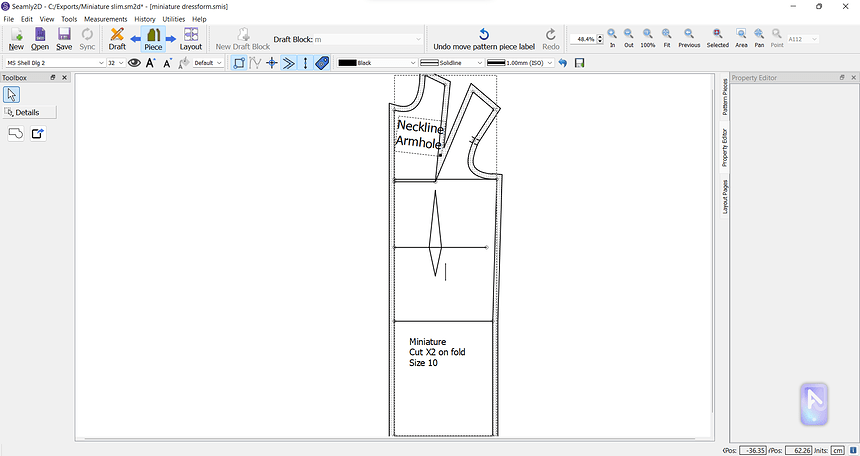

I also have a question about the label feature — is it possible to assign and position labels on specific parts of the pattern? For instance, placing the neckline label directly on the neckline, and the armhole label on the armhole?
